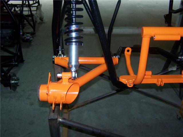

This was bought from them back in 2004:
This car is a Mini Pickup...with a turboed Suzuki Swift 16v, 4wd!!8-)
It is pretty quick!!

On 21st Aug, 2008 codd_coupe said:
On the Coupe, we use a whole front end subframe in the back. The bits are available to lock off the steering and for the gear change.
that picture is great, helps alot with one of my ideas, edit, hows the handbrake work in this layout.. is it like a line lock on the rear circuit?*smiley*h

that swing arm is what i saw at mitp (maybe not that actual one*tongue*) but with the rose joints and the engine- drivetrain layout is of the same as my plans with the diff in the back, iirc the swift 4wd uses the justy drivetrain so thats something to think about
thanks alot, any more pics?*happy*

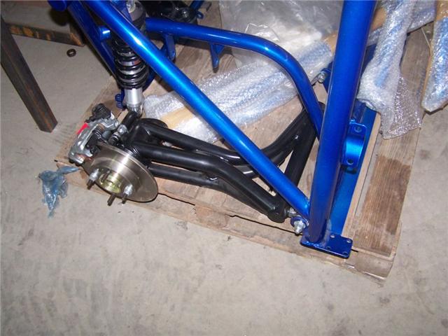

i have emailed zcars, and with in 15 minutes Chris Allanson from zcars replyed with pics, looks like i am buying from them when the time comes :)
they have 2 designs::)
EDIT i cant upload the 2nd pic :(
Edited by Brett on 21st Aug, 2008.
the other 2 pics dont seem to want to upload

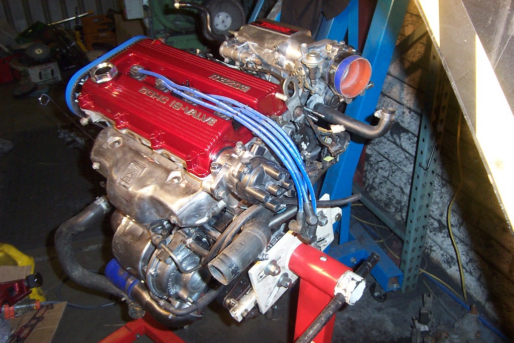

and a pic of the engine im going to try and shoe horn in there (not my actual engine *wink*)

On 21st Aug, 2008 Minibar72 said:
PS! Whats the price?
the price for the arms is £220 each + cv's plus brake setup plus obviously the coil overs plus the bespoke drive shafts at £110 each plus the material cost of the subframe and atleast a week to build*surprised*
i think im looking at close to a grand*frown* but this seems to be the simple-est option and in the long run the most reliable, mitp 50 gets closer by the day *surprised*
one think i will say i have sent 3 emails and got 3 replys within a single day, and Richard who i am dealing with knows his stuff *wink*
