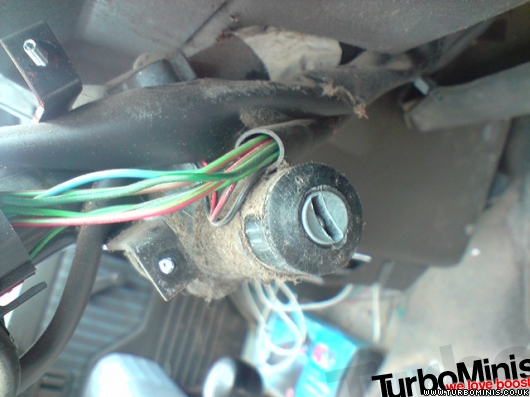

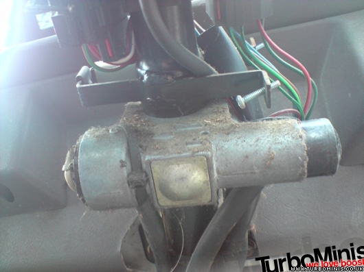

photos from camera phone:
i really dont wanna spend to much on this, its only to move fire equipment arount the site (already owes me £25 LOL)

just cut the barrel away from the column

in the first of those 2 pics there is a screw on the side of the barrel at the end furthest from the key. if you remove that the electrical part comes away and you put a screwdriver in to start it (easier that touching wires, especially in the dark) to remove the lock you need to remove the barrel
