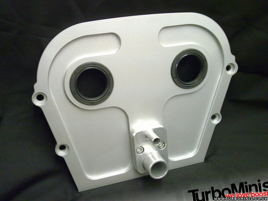

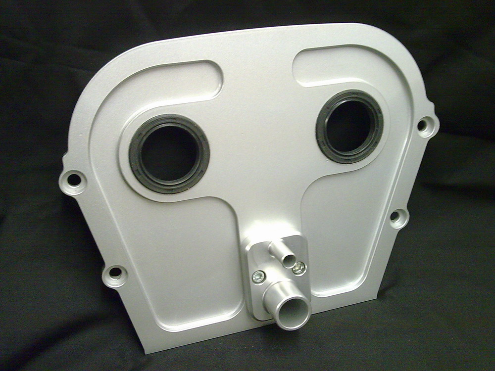

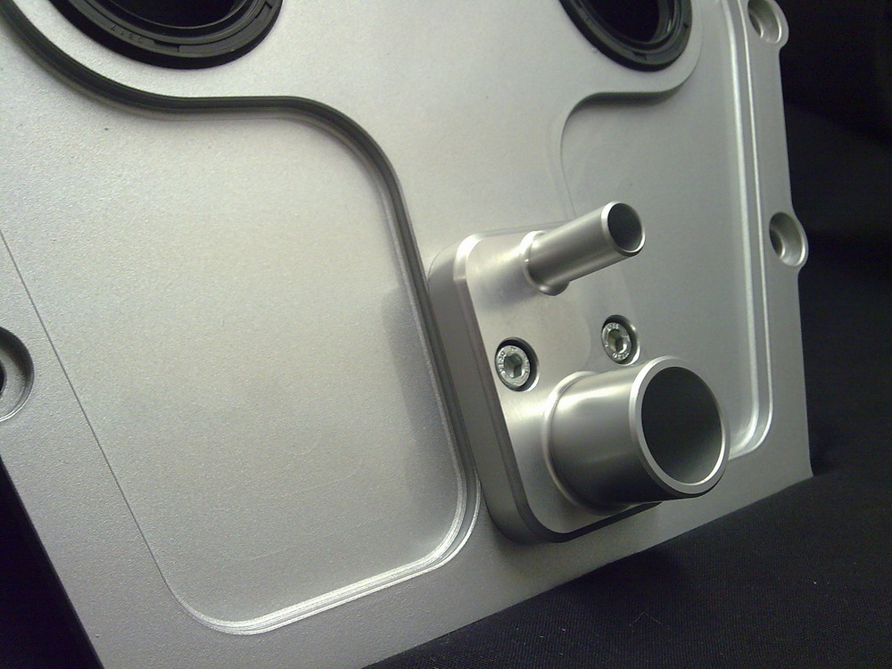

A few arty shots of the revised K conv front plate, bolt on piece has a breather and drain outlet.

VERY good! Removed the little issue I mentioned completely!
Just a thought, Is the oil drain/ breather bolted on upside down?
I would be happier with a bigger breather and a smaller drain *wink*

Nope - big drain is correct as there needs to be air (gas) in there as well to let the oil flow freely

Fair enough *oh well*
