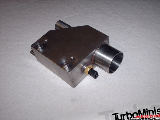

Mine's on my plenum, I'll post a pic tomorrow when I collect the plenum from Nic.
Ta Da:
sexy!
