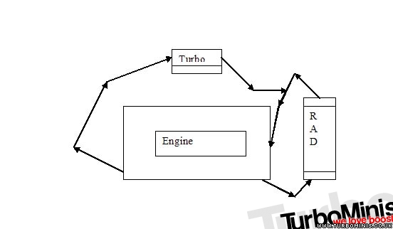

Becasue i have a GT17, i decided to take advantage of the water cooling. Now on my car i have plumber a hose joiner into the bypass hose outlet on the bottom hose and gone in a loop into the GT17. This is probably slightly higher than the rad, the problem is i seem to have a lot of pressure and the cap is leaking a bit. Do you think if i brought the hose down below the rad the problem would be solved? and i would obviously get rid of the air lock?

are you sure? the bypass hose goes from the pump to the head and does not go into the bottom hose. do you still have the heater?
When you say you've "gone in a loop" are you saying you're returning to the water back into the same hose? This could be the problem if so.
The additional heat put into the cooling system by cooling the turbo, could also be just be tipping the cooling system over its cooling capacity aswell? *oh well*

When i mean in a loop i mean the phsical hose, so the flow is like this ......
but the actual hose that goes from the turbo comes up above the rad cap then into the old heater take off, not the bypase hose (sorry oversight on my behalf)
I'm just worried cause there was a lot of bubberling in the turbo water lines and obviously a weaping from the rad cap?

I got an airlock when my hose to the heater matrix moved and went above the rad. The heater all of a sudden went cold. I would move the hose to a lower level!
Not sure if this is the cause of the weaping rad cap though? Because the water wouldn't be circulating through the turbo with an air lock, would it? Try moving the hose down below the rad level and see if it cures it?
You could be seeing an increase in temperature because a lot of the water may be going through the turbo and not the radiator.
I'm planning on connecting the outlet from the turbo into the top hose. That way everything gets cooled.

ministef1 your drawing is correct and to improve things you can go from the head, to the turbo, then the heater, then back to the bottom hose. this cools the water from the turbo before it goes into the main cooling system and helps the heater work better.
