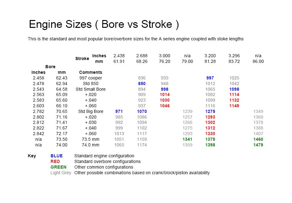

i have used the search but not really found what im after, i have been thinking about diffrent styles of engine builds recently with the chinanigans with the 1460 turbo ect. what would be needed for a 1275 short stroke turbo? its abit diffrent and its interesting me quite abit. what displacment would a +20 over bore on a 1275 block short stroke CC be? what are the pro's and cons of short stoke engines.
if i knew how to work out the displacement i would do it my self but i dont lol :)
all comments and information welcome

its not got every possible displacement on it but this is usefull, probably got it from some where on tm lol*happy*
