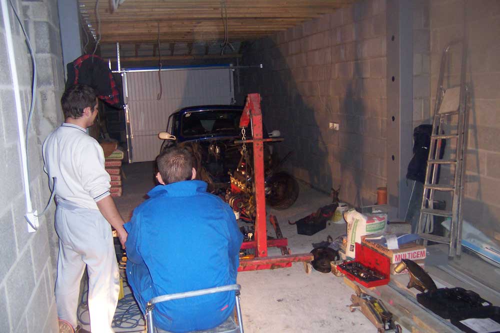

well after mat and tone poppped round in just 2 hours the engine was out and stripped down.
and as suspected 3rd gear on the laygear had let a tooth go, which in turn had hit the conrod and pushed it into the casing causing the hole.
there is a slight mark on the end cap of the rod which i will remove , examin and touch up.
so it is a new laygear, case and a few other bits.
i am now toying with the idea of going to a 3.1 fd but not sure yet were abouts in all my junk it is so a 2.95 may stay.
here is the pic of the new mega hog sty
nice pic mate, that still doesn't show just how big your new garage is! I lost Tone in there for a little while once!
Glad we found the problem, very unluck that it made a hole in casing, i hope you can buy the parts you need to fix her.
can the casing be rescued/welded up?
how bads the damage?
at least it wan't a hole in the block.
yes casing can be welded, it's only about 4mm round, it's under the nut where you fix to the block, so not sitting in oil, but hoggy said it still let 2 lits of oil out*surprised*
