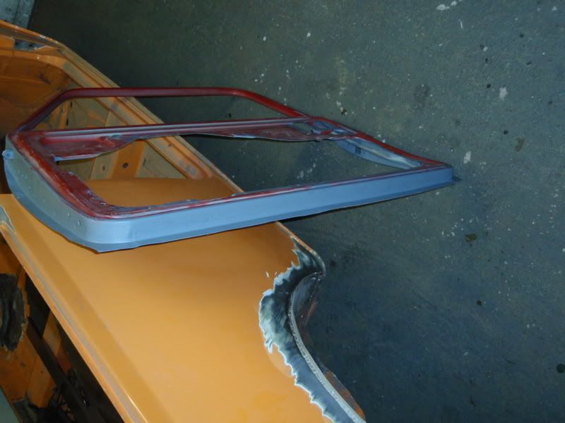

Then i slid it down a ditch and this is where we are now:
Front left hand corner got bent and the center of the windscreen surround pushed down, but have pushed it all back out and straightened it up.

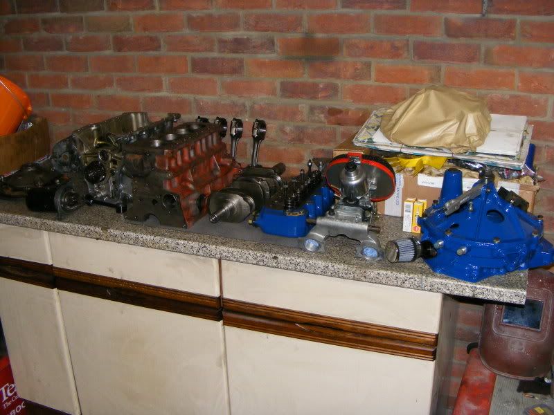

Engine is a Morspeed trackday kit (hardened and balance crank, balanced rods, center main strap, arp rod bolts, arp head bolts, phase 3 cam etc.) Which is needing a rebuild already after only 15k. Have got some new 21253 + 40 pistons ready and some other new exciting bits to go on. The head is a morspeed phase 3, which will either be modded to lower the compression for the turbo or sold.
All stripped down ready to be bored and rebuilt:

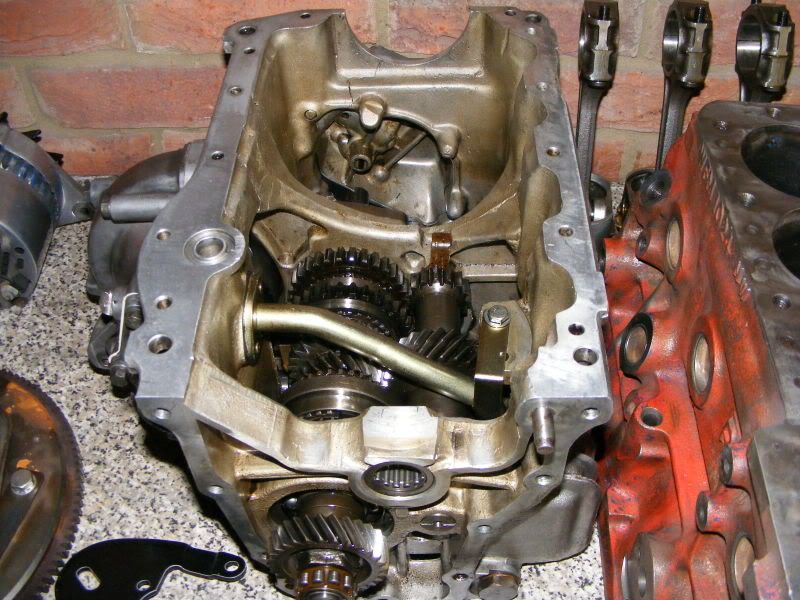

Gearbox - fully rebuilt standard helical, cpu, mini spares x-pin diff.

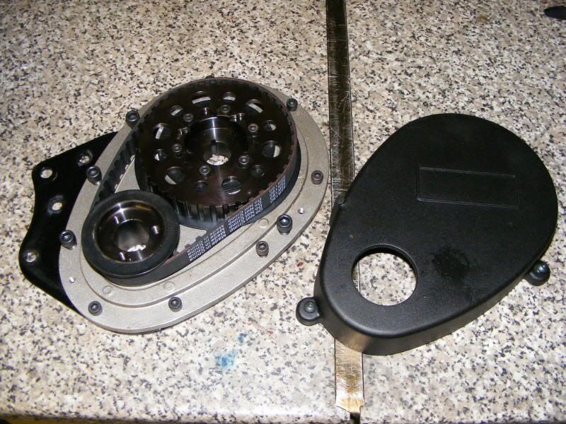

New timing gear i'm looking forward to trying out:

liking the timing chain cover, wheres that from, never seen one of those before?.
133.5 bhp 123 lb torque 116mph @6640rpm 9.5psi

Its a minispares vernier belt drive timing kit, designed to reduce timing scatter and run quiter.

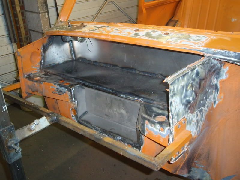

More progress has been made this week.

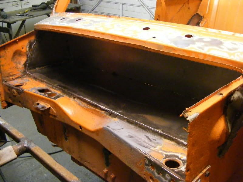

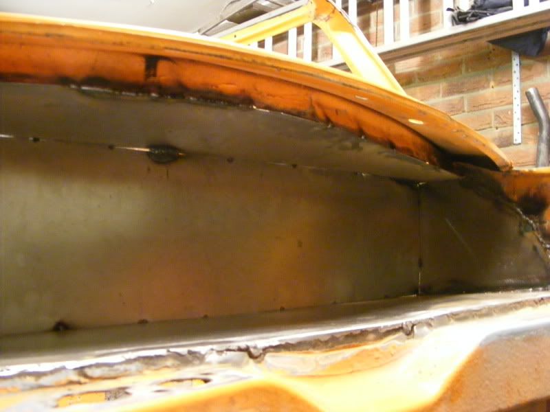

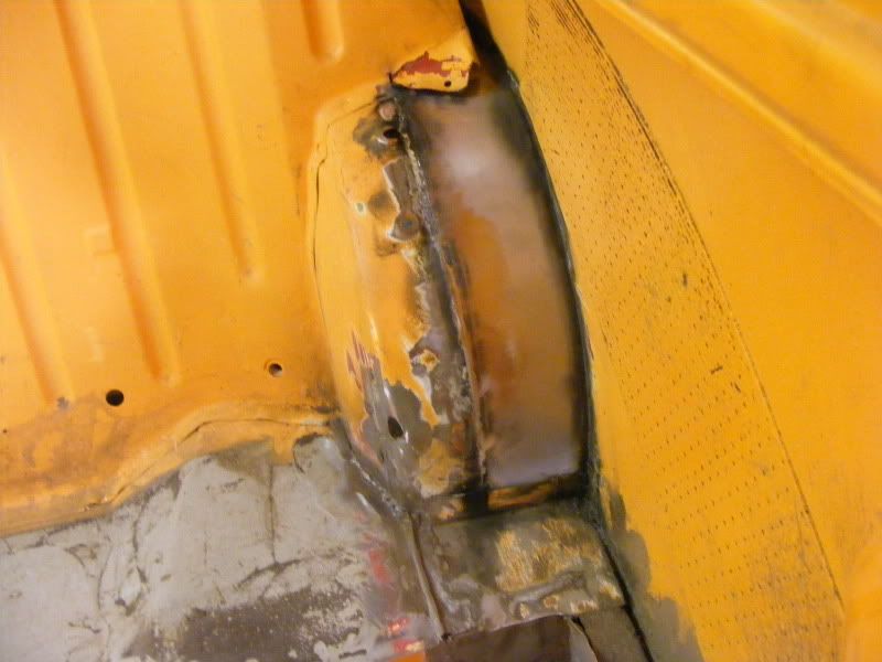

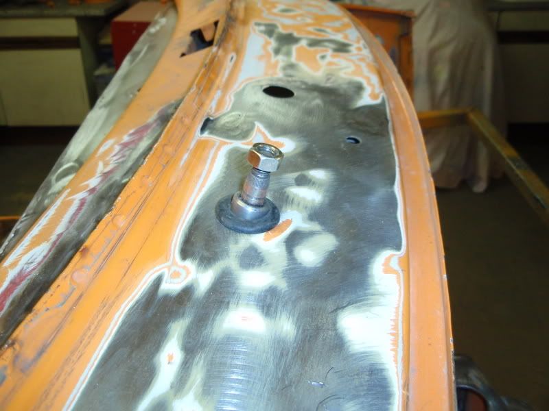

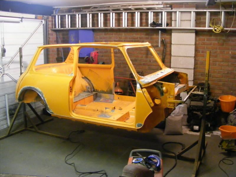

Bulkhead boxed out, still needs a bit more welding as some of the seams are still only tacked:

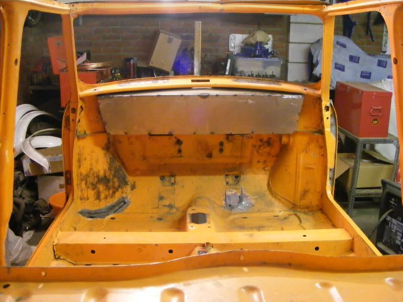

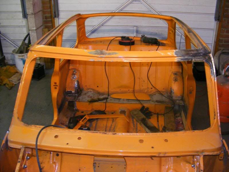

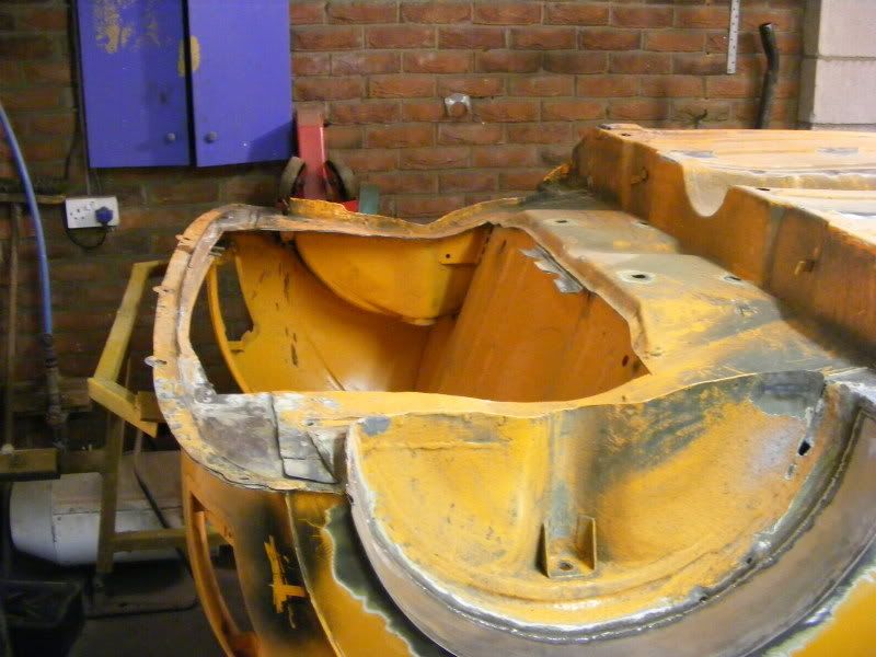

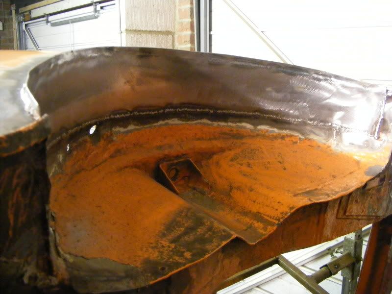

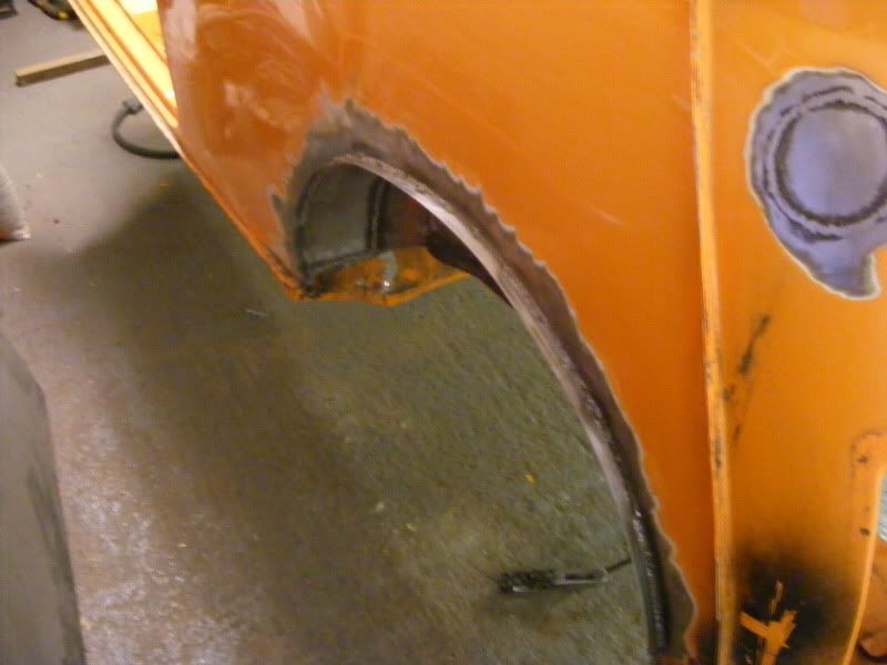

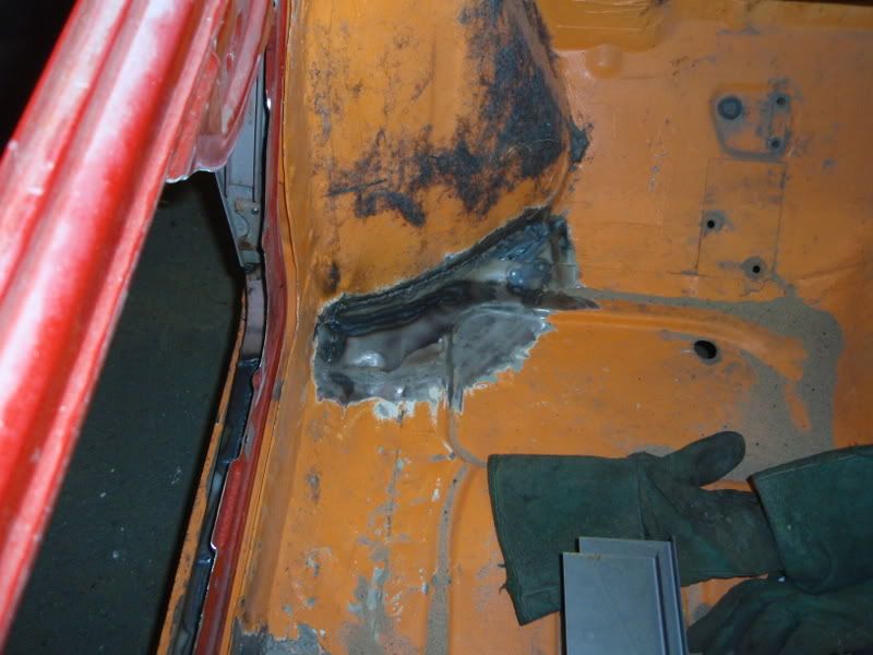

Both rear arches tubbed:

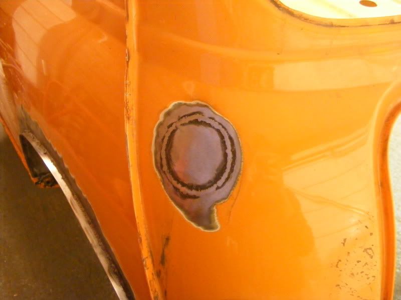

Petrol tank hole welded up:
Boot floor cut out ready for flat sheet:

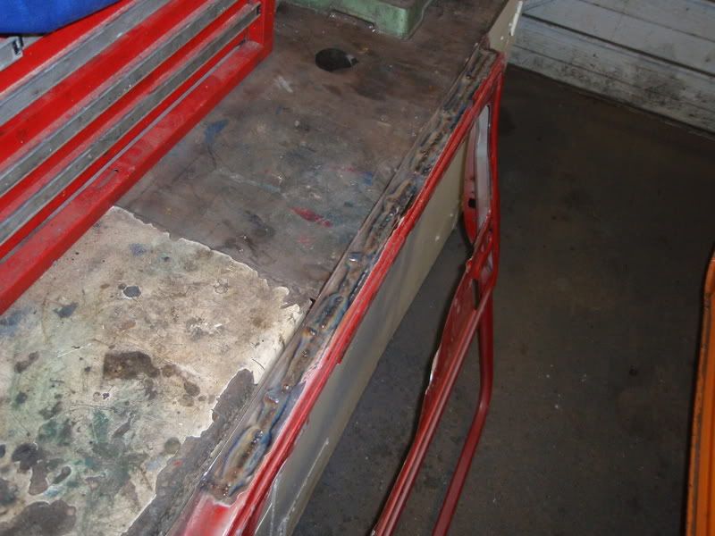

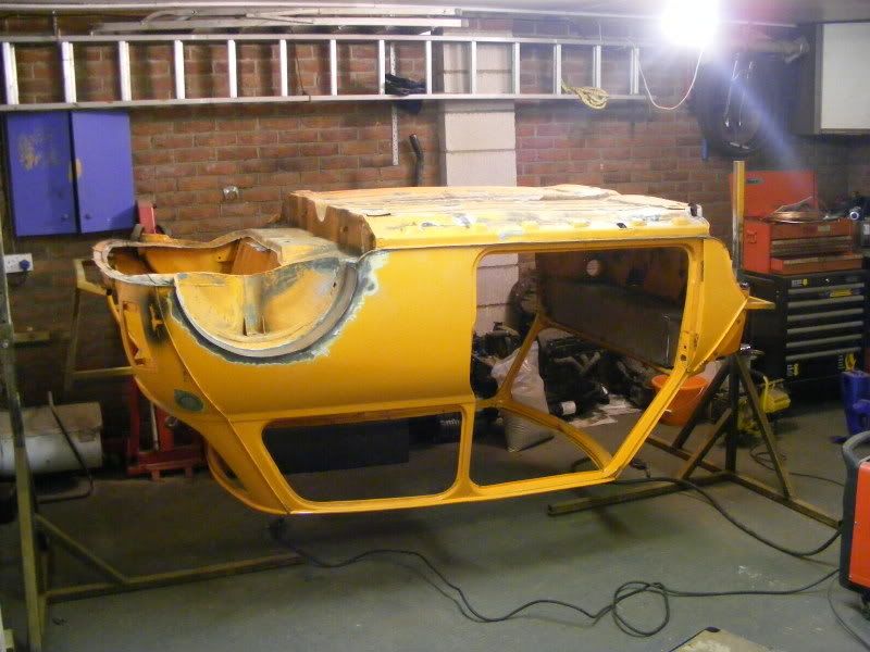

The best thing I've ever made, makes it so much easier to repair/modify a shell:

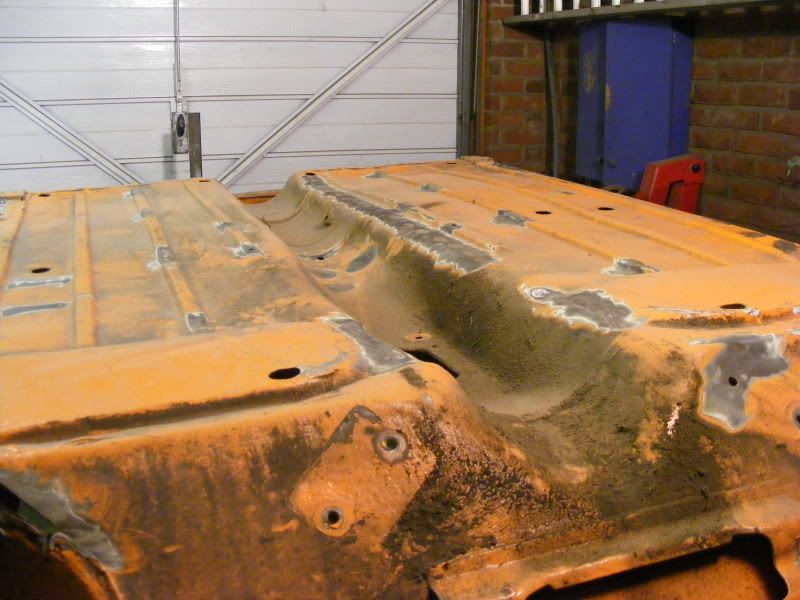

All of the tabs and battery cable strip removed from underside of the floor:
Also got the roll centre miglia spec cage ordered, should be here in 5-6 weeks time.
looks similar to something im doind in my garage! only your actually making progress!! love the pit youve made! im tempted to make one myself only my garage is alot smaller than yours!!
advantage998
458 Posts
Member #: 1840
Kings Lynn, Norfolk
Yeah it only cost £40 in 40mm box section and 3/4 hours designing cutting and welding it together.

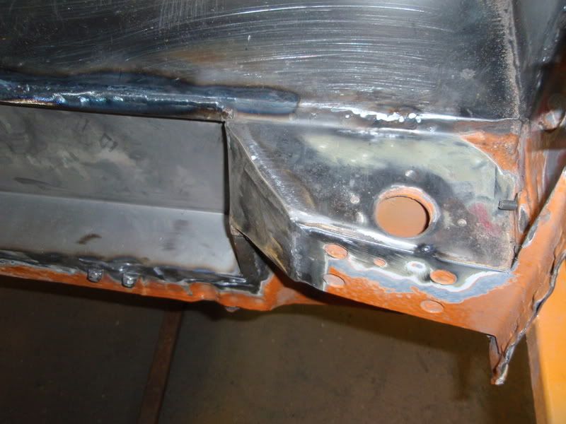

Front n/s foot well corner replaced:
Bulkhead box (supplied by millamber) fitted:

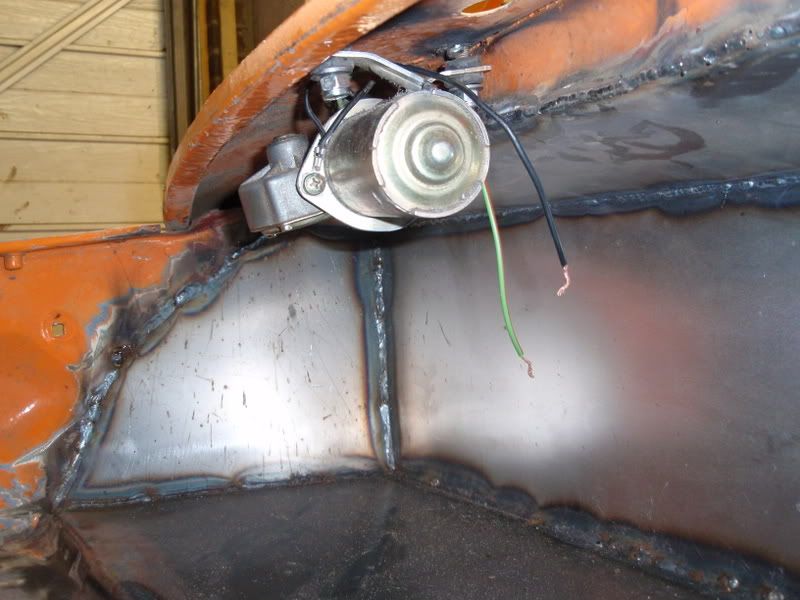

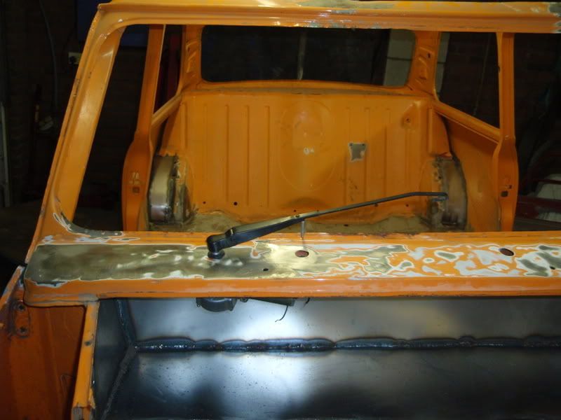

Wiper motor set-up figured out. Started off with a standard motor from a metro afaik, and shortened the shaft down and made some new fixing brackets:

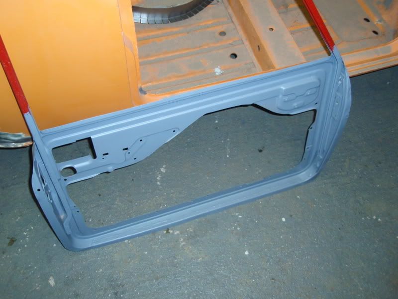

Door bottoms replaced, and a bit of weight chopped out of them, just waiting on the alloy skins now:

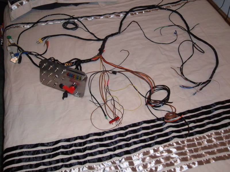

95% of the wiring loom finished, just the shielded cable needed for the ecu, mock up panel of the switch layout made aswell:

Looking very professional. I wish my wiring was that neat!
On 24th Dec, 2008 Nic said:
That looks a top build. That wiper motor looks familiar. Glad it's been usefull for you.
Neat wiper solution.

The wiring has taken a lot of planning, supprising how much it costs to make a loom, when you add up all the cable, and switches.
Thanks again for the motor, just got to figure out the park switch wiring now.
