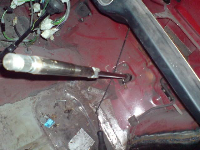

Which moves on to today with help from this man i started to re-locate the wiering inside of the car ready for bulk head box area to be cut out and bulk head box to be welded in.

i must admit i don't think the angle of the handbrake was the greatest idea *wink* lol...luckily i didn't sit on it!

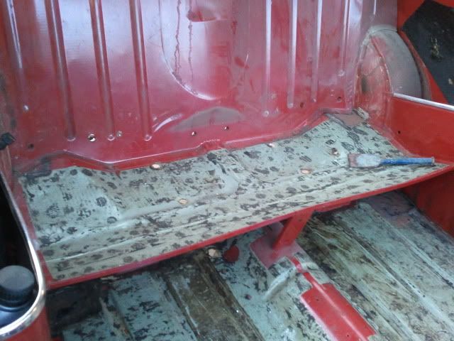

Done some more to this today, i had forgoten that i gave up getting the bitumen sound deadaning off the floor as i was getting to cold to do it, i finished this off today and was amazed by how much it weighed.
I managed to get behind the drivers chair finished off, the rear seat base and about 1/4 from behind the passangers side, all of this weighed in at a massive 3.4kg for just these small biys thats not including the front and 3/4 from passangers rear section!!

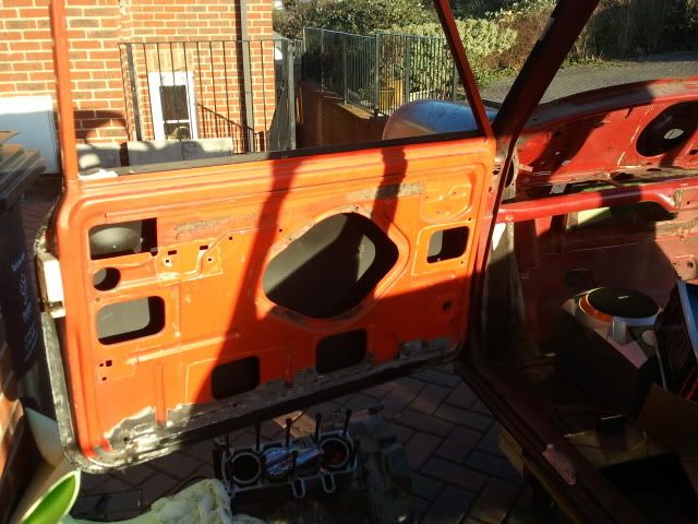

Next on my list was to start working out where to lighten the doors so i have marked it up with pen where i plan to remove metal from(plan to use plastic windows), after this i marked up where to cut to remove the rear seat as i want to leave abit just incase it goes abit wrong.

abit more of an update spent alot of time trying to find a part for my angle grinder to chop the doors up with i was mightely pissed off when i couldnt find it so i drilled more holes instead. unfortunatly one of the holes messed up abit and i took a small chunk of metal off the exhaust tunnel when i bashed my knee on the sill, hopefully this can be welded back together with ease but due to location im not to sure as im a novice to this sort of thing.

edit i also forgot to add the areas i have cross hatched are places i have been thinking of cutting out what are your views on this? the doors seem to be okay but the inner wings im not to sure about as i dont want them there and use brace bars instead.
paul
Edited by Paul R on 18th Feb, 2011.
i would not cut out the inner wing
I wanted to for abit more room and use brace bars instead.
