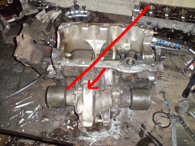

I sort of put the bar at this angle and whack it in the marked direction.

Ahh.. Iv been doing this all wrong I think.
I placed the bar on the actual driveshaft - past the rubber boot. Kept slipping unsurprisingly.
So that (collar?) should come out with the driveshafts then when you bang it out with the bfh???
yep,
