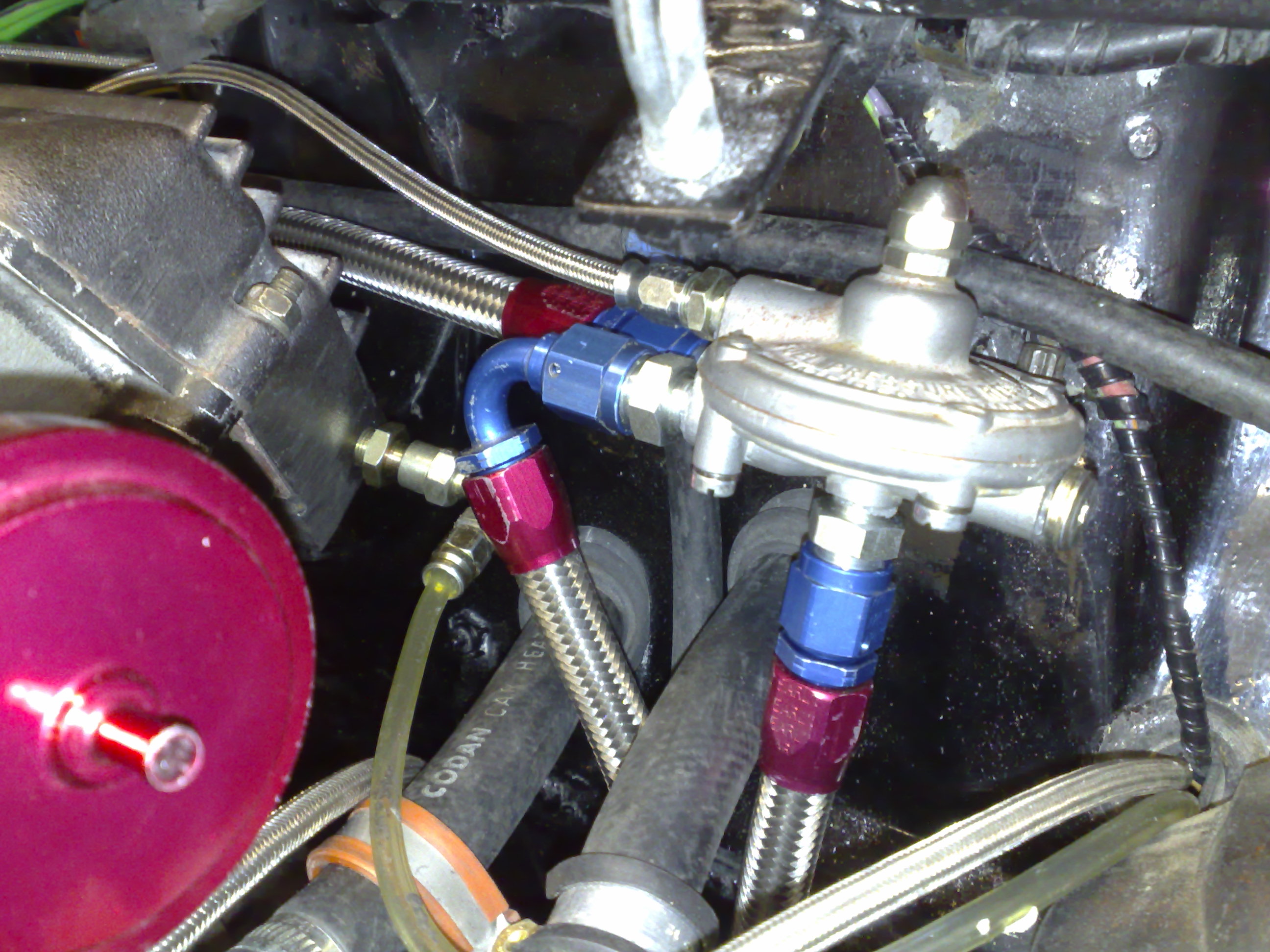

Beach grove engineering 01525 382968 Speak to Alan
Tell him Josh gave you the number.
He did all my pipes and fittings and he has every thread type going. And If he does not have it he will the next day.

On 10th Nov, 2008 TurboDave said:
So all you need is a 1/8 BSP to 1/8 BSPT adaptor? Is this not an easy thing to source?
But you can mate NPT AND BSPT did this on mine. No leaks all you need is the tap.

All the male male fittings above are 1/8 BSP parallel to a tapered body fitting.
Edited by Mr Joshua on 10th Nov, 2008.
