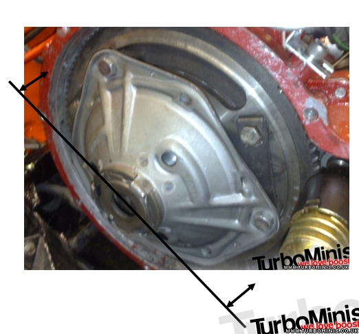

Take a look at the picture below:
I need the distance from the outer face of the flywheel housing (that the Wok is bolted to) to the washer on the flywheel that the release bearing contacts.
I have got one pre-verto engine in my whole stash - and it's the one in my mini, which takes a lot of time (that I don't have) to remove...
Sooooo, if anyone has an engine or a few engines they could measure - i'd appreciate it. The more dimensions the better - obviously there will be a lot of tolerance in the range, especially with different covers and new/worn plates - so the more dimensions I get, the better... I only need to the nearest mm or so, but if you use a digital caliper I won't complain!*smiley*
BTW - I found when doing the Verto measurements, the best way is to make a 'bridge' to measure from. I put two (long) impact sockets on a piece of 1" square alloy rod and held them in place with a single wrap of insulation tape. i could then measure the distance between the bar and the clutch washer, and subtract this from the height of the sockets to get the dimension.

Hey thats my setup! I want royalties you bugger. I have a transfer housing i can measure for you tonight. And a spare wok, so i could just measure to the bearing?
Or is this not accurate enough??
I have an engine but not enough bits to make up a complete fywheel assy.
can take the measurment to the end of the crank though if thats of any use,
or maybe a measurment less the clutch plate, sou you need to take off the thickness of the friction plate.

Hi Mike, Yes, I twocked your picture like a pikey with a hi-ab...
Mike - I'd rather have the info straight off a flywheel / engine...
Mini13 - There are so many variables, I'd prefer to get a range measured at the area I outlined.

dave got one in the garage but your pic does seem to be correct as the arrows go off the screen... so I'm not sure what you want measured
