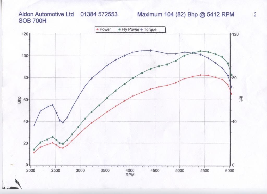

After many weeks of frustration, blood and sweat and help from BAT (gavin) i managed to get it back on the rollers at Aldon who have been very good and helpful
this was the first run before all the problems
this is the run today
I have changed the chokes from 38-36 and au choke from 4.5 to 3.5 and the exhaust from a 2inch to 1.75. They have rejetted it and the graph is much better coming sooner, smoother power and torque band and still going. A little more power which is always appreciated.

yep megajolt working, after checking everything, the trigger wheel had slipped therefore timing was out and the map had not been flashed to the ecu. so all sorted fingers crossed.
spec:
1380, 37x31 valves, 45 webber using MAP at the mo, but will be changing to TPS. crane vp3c cam, 4 speed scc, with 3.4 quaife
makes good power
nice curves too

kent's version of crane's VP3C lcb manifold, maniflow 1"3/4 straight through box. inlet is superflow but will be changing this when I go onto TPS
Max Road VP3C Crane/APT 276/288 8.01 8.41 0.315 0.331 2000-7200 105.5 71 0.394 0.414 0.410 0.430 0.473 0.497 0.536 0.563
its abour right the power .... but i would have liked to see another 10 BHP
me too, how would I get that??
