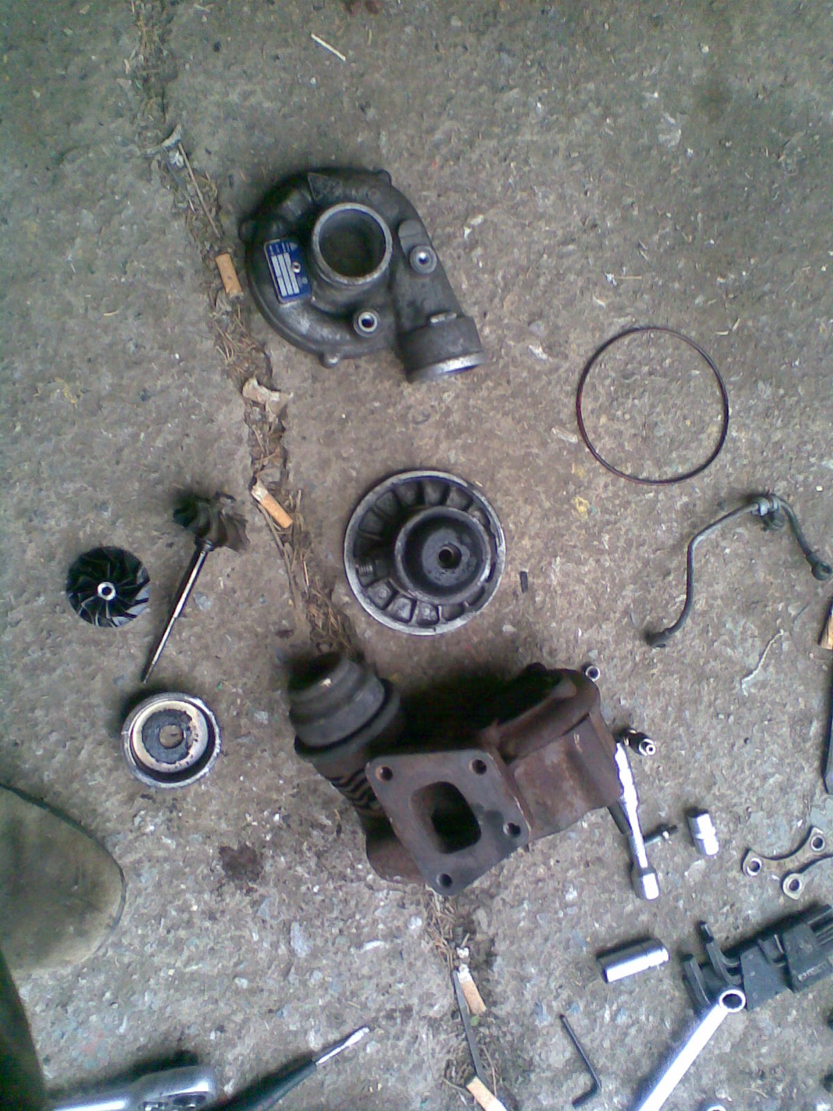

Hi all, I found this part, it's a KKK turbo from Seat Toledo 1,9 diesel TAXI. Please, do you have any idea what can i do?

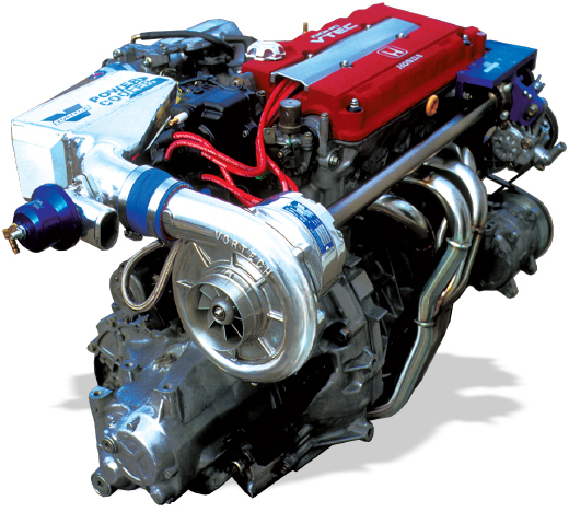

I think about to convert into a compressor, something like that:

some pictures:
the first picture is a supercharger :) it would in my eyes be quite difficult to convert a turbo into a supercharger. as for the turbo its self it wont be much use on a peterol turbo as it will run out of puff on higher revs

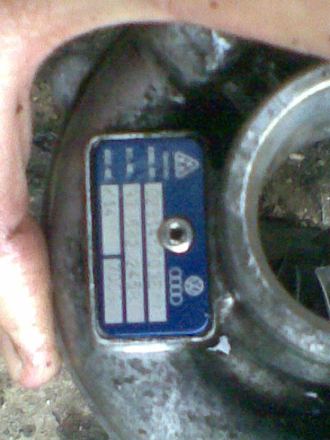

the k03 (with my quite basic map knowlegde) looks like a pretty good turbo. starts to lose its efficiency at around 20psi and good for a touch over 200bananas.
the k04 however is possibly abit big and looking too close towards the surge line but is more efficient at the higher boosts.
however once more! the k03 is the turbo used on the 1.8T petrol engines so i would have thought that this would have been smaller than that. so it could as paul says not be much cop in the higher revs but give a great low boost town driver!
what numbers are on the tag? i cant quite make them out.

Sorry, the only i remember is "K14" tomorow I 'll post the other informations from the blue label..
