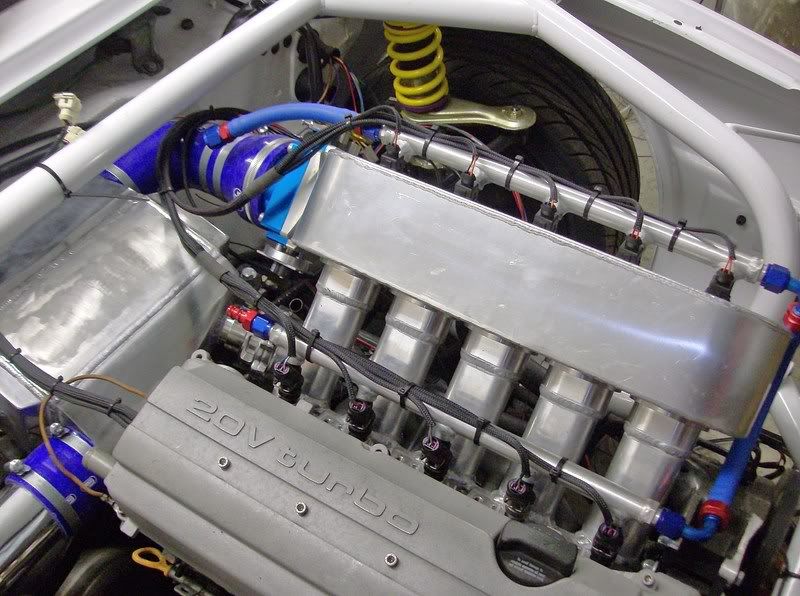

like the look of these hoses:
but are these push on blue hoses suitable for injection pressure like this chaps using?
is this the same stuff??

no the link is different stuff. this blue stuff is for fuel. it is much thicker and twists onto the AN fittings.
No that is the same stuff, there is only one blue hose for push on fittings, and that is the stuff. I was concerned at first with the description by both Merlin and Demon Tweeks as for oil oinly but if you download the Aeroquip catalogue and look at their specification it is suitable for fuel.
This hose is only suitable for the fittings that go with it, do not mix and match especialy if you intend to use it with fuel

Here is the catalogue, page 12 *wink*
brill, how simple is that!
