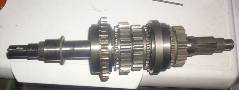

Getting there:
Just need a new 1st gear (mines a bit worn) and a 3.1cwp and I can finish it off.
