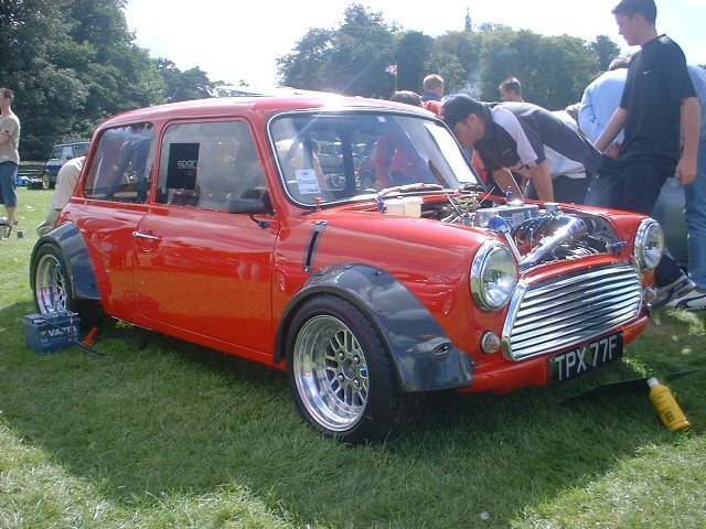

Does anybody have any specs for the engine in this mini, or even better the issue of miniworld it was featured in?
Cheers, Oli.

Amazing motor that. Don't know when it was featured, but I know its also been on one of the Ultimate Mini DVD's.

Yeah thats where i first saw it, but they only give you basic specs on it, like it being a 1460 swiftune engine, a minus shell, beam axle etc.

1460 all steel Swifty motor, full race spec, 310 scatter, dogbox etc. £10,000 at the time for engine and box

Engine.
1460cc all steel
Carrillo rods
forged omegas
310 steel cam
full race tunnel port head 37/31
45 webber on 5.5 inch inlet
mbe mapped ignition
Gearbox.
straight cut 4speed
quaife dog box
1:1 drops
Quaife lsd
3.9 final drive
group A shafts
Billet flywheel
paddel clutch
Brakes.
KAD six pots
10 inch discs
ap master cylinders
kad bias pedal box
Suspension.
Solid mounted
Hi lo's
AVO dampers
Rose jointed bottom arms?tie bars
Kad anti roll bars
Kad alloy radius arms
Avo coilovers at rear
Home made beam axle
Wheels/tyres
7x13 billet image split rims
yoko ao38's
Performance (from the mag)
154 bhp @7500 flywheel
120lb/ft torque @3500
Weight 520kg

Specifications: badass!
It is my pc wallpaper lol..

Interior reads much the same, everything and anything you'd ever want from sparco seats , curley dash and stack display. oh and a 800 pound headlining.
Says hes spent 28k plus, i can beleve it

what times was that running on the 1/4 does anyone know?
id say low 13`s at a guess.

It never ran a 1/4. TBH weighing 520kg with a long stroke motor, 3.9 diff and 13" wheels, I doubt very much it would go under 14 secs
