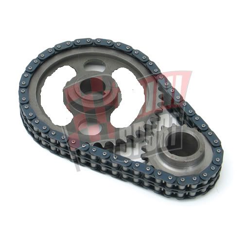

forgetting vernier and sticking with a normal duplex kit, could it be lightened any further than the lightened version you can buy?
1. standard duplex
2. lightened duplex
3. possible further lightening??

You could possibly get away with joining every 2 holes together to make 4 slots but why not buy the Swifty alloy centre set or the MED all alloy set?
Paul
its just an idea as i ulready have the normal duplex kit, so to lighten the one i have (save pennies) or just buy a new set
http://turbominis.co.uk/forums/index.php?p=vt&tid=170151
The Swifty one is quite cheap, not sure about the MED one though
Paul

Arent they made from fatally weak sintered steel and neeed as much meat as poss.?
So what do you achieve by lightening this a further 29 grammes?
29 grams less wieght!

Number 3 is a definate NO! Just asking for breakage.
Stick #2 in a lathe and reduce the inner "shoulder" of the sprocket rim.

Put a chamfer on the sharp corner near the edge, thats what i do when im lightening the standard ones. (attulay thats what he said^^)
I dont think id risk the 4 slot approch tho.
