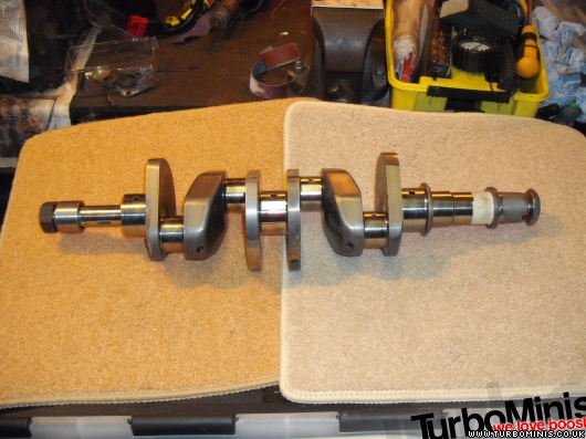

Just thought I'd post a few pics of the crank for my new engine after it came back from being balanced. I'm finally getting somewhere - the block is prepped and the pistons, rods and crank are ready to go back in. Next thing is to decide what head and cam I'm going for.
The crank is a billet short-stroke (64.3mm) unit, which with the 74mm bore (not my choice - the spec as I bought it) will give me 1106cc. With the 1.4x equivalency for forced induction that brings me to 1549cc - just a bit short of the 1600 class limit.

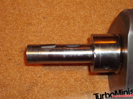

Notice that the crank has a long nose with keyways to allow two pulleys - my guess is that it was orginally made for a supercharged engine.

that crank looks fooking heavy,obviously a special, any idea who made it so i know who to avoid,lol

most cranks will be fooking heavy compared to the one that you run in the don have you any pictures to see what one should look like.*happy*

Mike the cranks been polished a tad........ but its rather heavy as Carl pionts out.
with that stroke the engine will be a screamer for sure!
i would go for the phase 2 cam and time it in a little late possibley around 112 deg depending on the bower your contenplating on a T2 possibley ? ???
................ anyone else ? *smiley*

Looks great. Heavy crank is good when you're dealing with a screamer. Especially when the weight is in the correct place, like yours. I'm jelous!

I agree! I really like the look of that crank! Do you know who made it?
Phase 2 is the current favourite - planning to run with a GT1752 turbo.
Don't know much about the crank - all I know is that it came out of an engine built by Bryan Slark.
