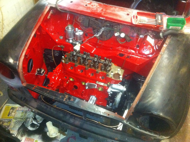

Right rather than start a new thread Im hacking this one instead. Basically Me and my dad are restoring a Mk3 Cooper S. It started as a simple engine out bit of body work job but turned into a nut and bolt rebuild. So far,
Both Subframes removed, stripped, blasted, pcoated, rebuilt with all new bearings bushes and pipe work. Subframes are now back on and the car is on wheels.
Engine has been totally stripped, cleaned, de glazed, checked and repainted. The head has been ported with ss valves, new bronze guides, and new 180lb springs fitted. Rods, crank and pistons are the same. The Cam has been replaced with a Kent MD286. Clutch is the same just a new plate fitted. Were dropping the old clockwork dizzy for a MJ tps style.
The engine has been plopped back in as of a late shift last night by Dad and I, with ease I must add.
The body has had some fair work done,
2 New wings, New Front Panel, 2 New A Panels, 2 Scuttle ends, 2 Door Steps, 2 Sills, Valance and Closing Pieces and finally 2 roof drip rails.
Next step is to get the engine running, i just need a tps sensor, crank sensor and coil pack with the appropriate wiring.
The car will be running on the standard Twin SU and a 3-1 Manifold.
Can anyone recommend a suitable TPS that I can rob from a scrappers?
Mike
