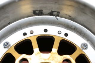

cheers chaps i shall look in to it, heres a pic of exactly whats happend

Umm, so you are only using 12 instead of the possible 16 holes.
That may be telling you something.

theres only 12 possible fixing holes on the 'face side' of the wheels, should the inner half of the wheel be fixed on with 4 more then?

If the outer rim and centre are only drilled for 12, then you have to live with that.
My SC rims have 16 bolts.
MB wheels have only got 12 bolts.

Of the mb wheels i have seen the rims are drilled for both a 12 and 16 hole pcd. I haven't actually seen centres for a long time for the mini centres but we use them all the time at work and have 13" 16 hole wheels for the f1s.
