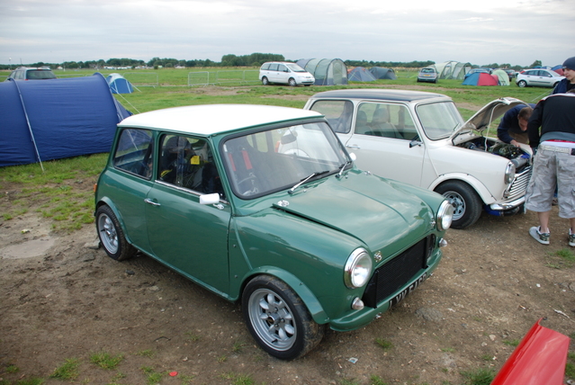

I need some help on trying to make out what size wheel & tyres are on this mini that has been posted by dan_up in a previous post. I am planning on swapping my 7x13 ultralites for something along this size. To me they look like 12's or 13's ???? Can't decide on the width & tyre sizes. I like the way these sit from the arch.
Any help on this or if the person that owns the car frequents this place?
Cheers.
thats ians car i think on 13's
id say 6x13 superlights
Rick
Rick
Agreed
Paul
3rded
i'd say possibly on 185/55/13?
or maybe 185/50/13

Thanks guys. seems like they are 6 x 13. Anyone know which arches these are?
They look like standard Mayfair/Cooper to me

i have them wheels on my clubby :)

ive got to start marking my pictures!!! lol
On 23rd Aug, 2010 Nic said:
Turbophil had a butt plug made that seemed to be suitable. He may have finished with it now and have it kicking around spare
6x13, 175 50 13 a048's on the front and 175 50 13 a539's on the rear. dont ask me how i know this!

LOL. Perfect answer Paul R. Thanks mate.
BTW..... How you know this????
tyre tread pattern from where he reversed and the sidewall shape and lack of heavaly visible tread on the front, the fact they are not to bulged ruled out avon tyres and slicks are bigger lol. :)

my thoughts ..........Paul R has it thought
the wheel expert is AKA ...... fastcarl

sorry gents, not been on here for a while as been away.
Paul R is absolutely spot on with his observational skills! (although i am slightly worried my mini isnt still in my garage at home for you to know that much detail!! lol)
they are 13x6 superlights on the tyres paul worked out. arches are standard mayfair type ones (think they were called mini special arches or something from mini spares) they are usually like a matt black plastic grained type finish but mine have been expertly smoothed and painted by Nic (ok abit of filler primer and some thick paint!) so they are quite sniny now and body coloured *smiley*
