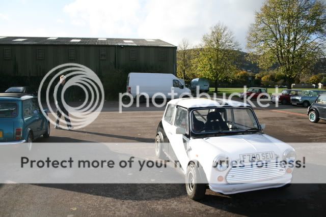

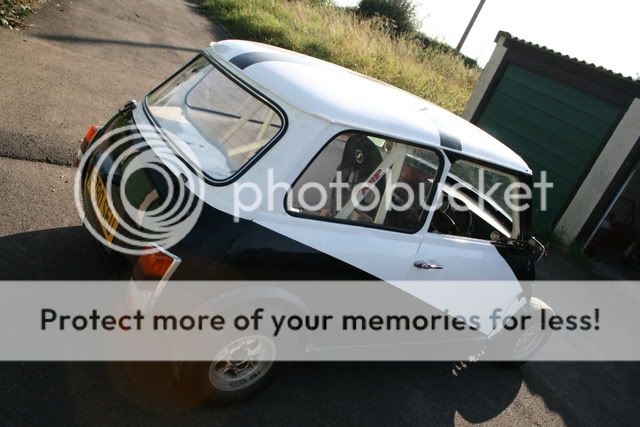

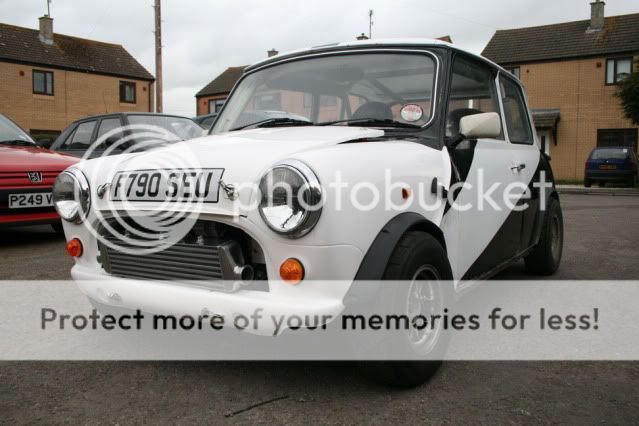

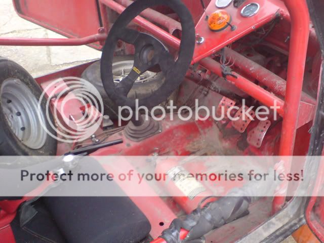

It started out as an ex autocrosser, which ofcourse wasnt road legal. so we made it road legal.
these were just after i got it back in 2007.

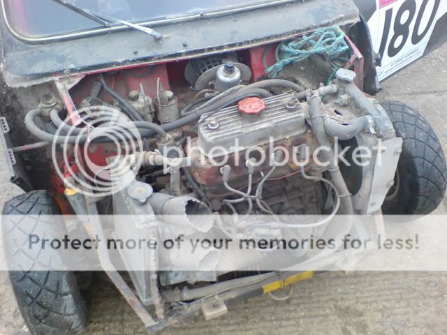

what a mess

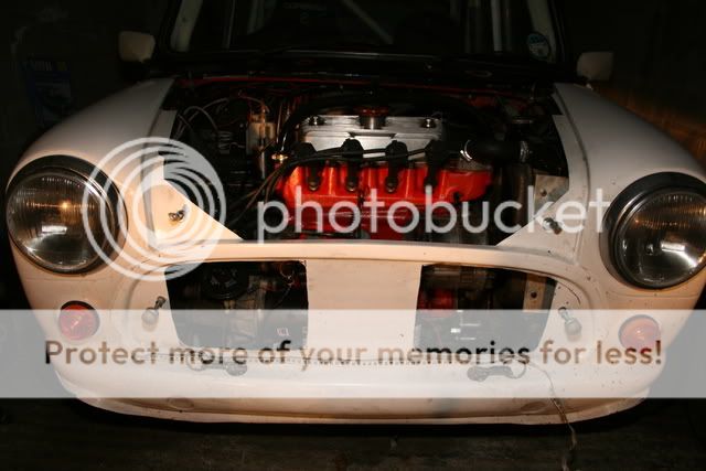

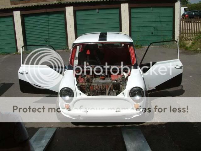

new fibreglass front fitted

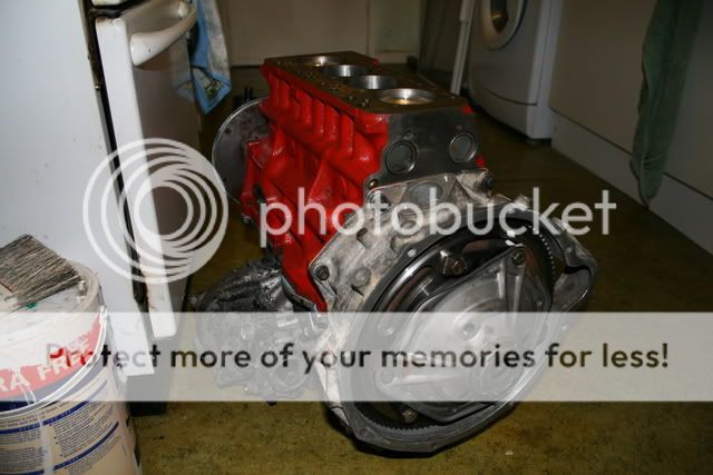

once it was legal we found that the engine was pretty much crapped and the 4.2 (i think) diff was ridiculously short for road use.

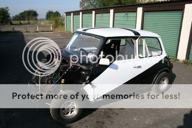

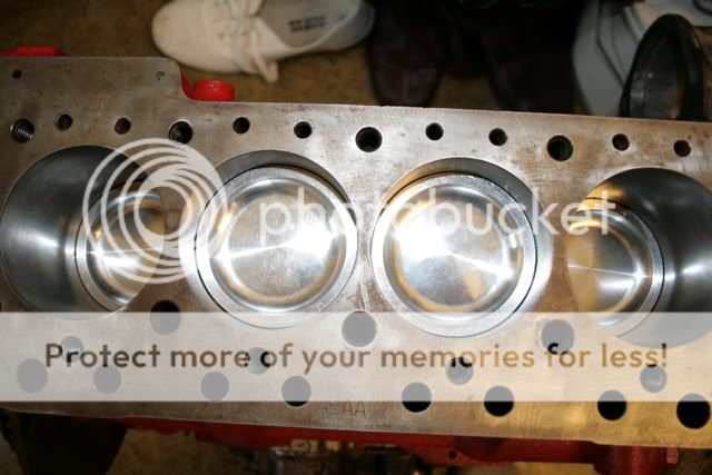

Late 2007, after reading and learning alot on here we decided to build a new engine, and turbocharge it *surprised*.

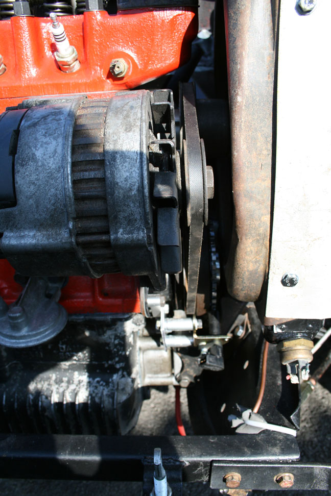

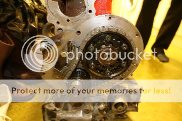

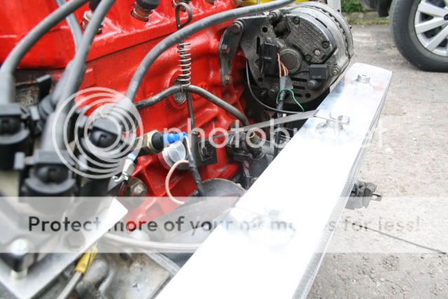

Crank sensor mounting. SC sensor bracket fouled alternator belt so had to modify it.

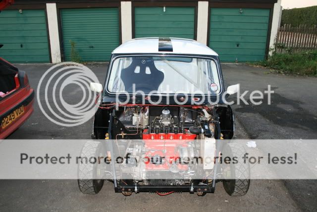

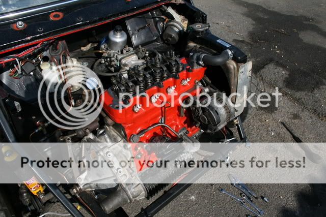

Engine in, running it in without turbo to begin with. Goes pretty well for NA 8.2:1 compression.

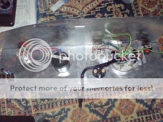

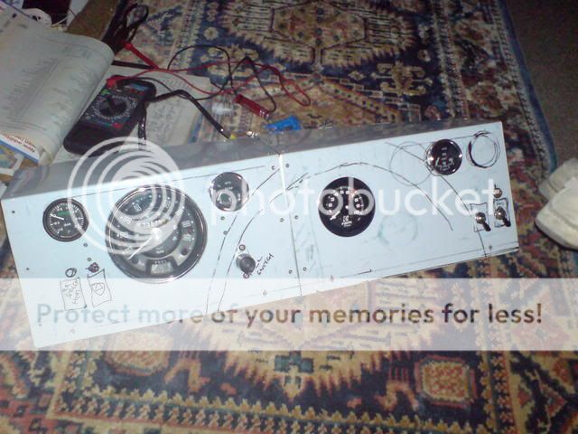

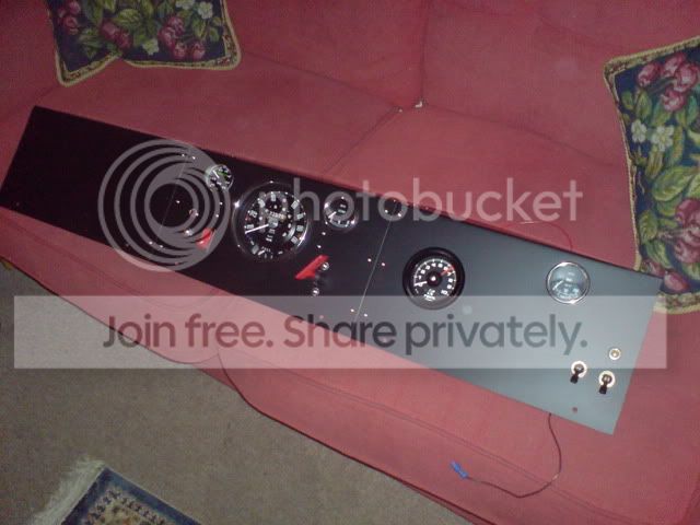

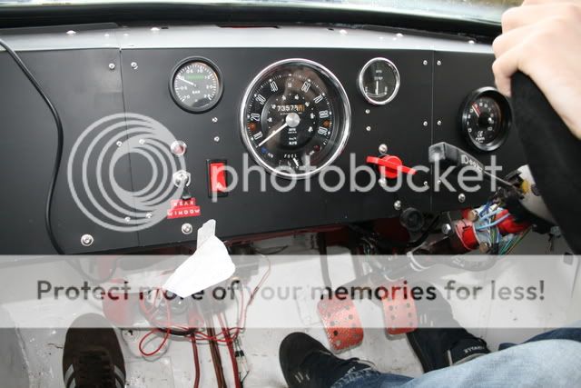

Home made dash from sheet ally, came out really well.
covered 500 miles so far, and im in the process of wiring Megajolt up. im going to stick the T3 turbo on and run it on low boost, no intercooler for a bit and then wind the boost up with an IC once im happy.

1293cc A+ block, Forged Accralite 14cc pistons, standard rods and crank with ARP nuts/studs, assembly balanced, Centre strap, Phase 2 cam, Piper vernier duplex, ultralight flywheel, grey diaphragm, Benross head, SC drop gears, x pin diff, standard gear set, standard T3 turbo, Megajolt V4.

Dash does look well, and the spec sound spot on.
Keep the pics coming.

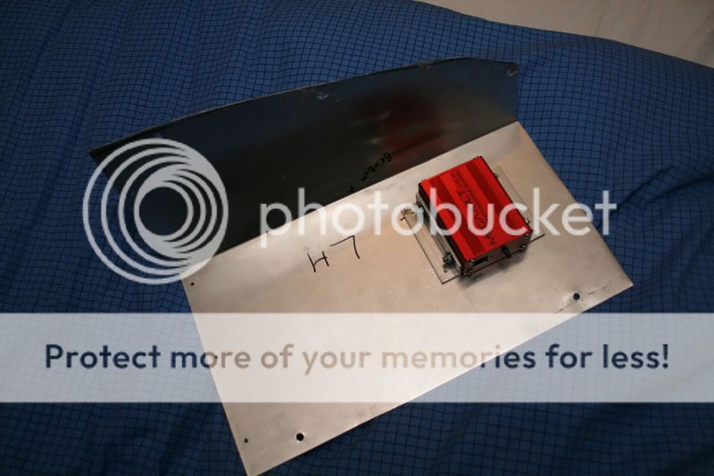

Megajolt now mounted to back of dashboard.. just got to run the 2 wires from the edis to mj then that should be it!

Some questions if I may, do you have any clearance issues with that trigger wheel on the front of your damper. Does it not foul on the engine mount?
Ans how did you get such a good finish on the dash, looks like satin powder coat to my untrained eye..?

doesnt foul at all hario, a little room to spare. I did think "oh crap!" when i was fitting the engine mount but it slotted on nicely.
as for the dash, i wish i did powder coat it now. its just halfords matt black spray lol (came out satiny) on primer.

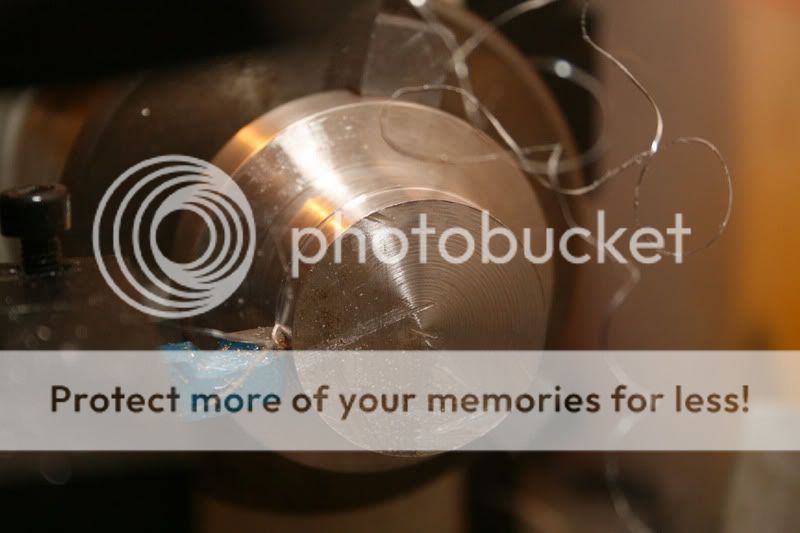

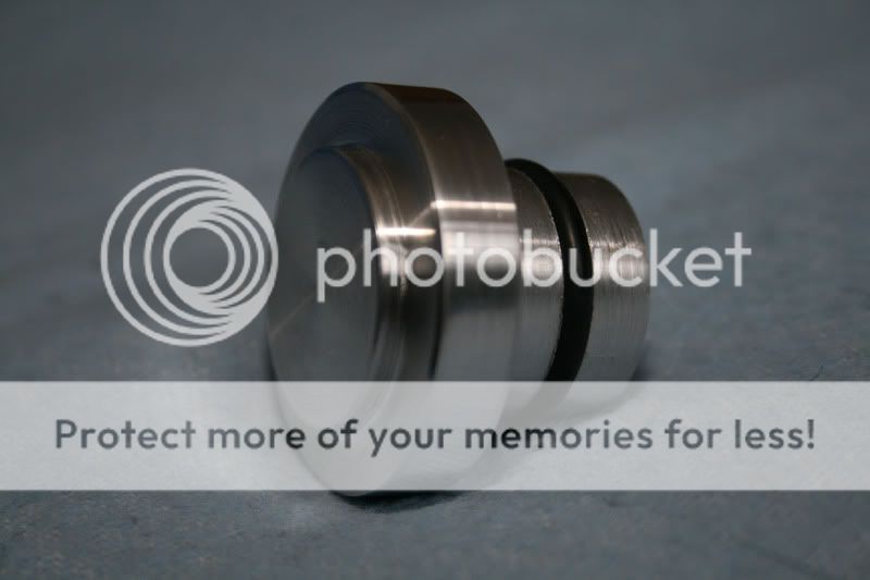

Lathed up a blank for the distributor too.

Nice plug. Can you show me a pic of Your lathe? I'm thinking about buying one somewhere in the near future. It pisses me off when my machinist tells me to wait 2-3 weeks untill he is free.
Monkeh
159 Posts
Member #: 1997
Lichfield
hi, its pretty much identical to this one, just under a different brand. http://www.machinemart.co.uk/shop/product/...thes-milldrills
thanks for the compliment on the plug!

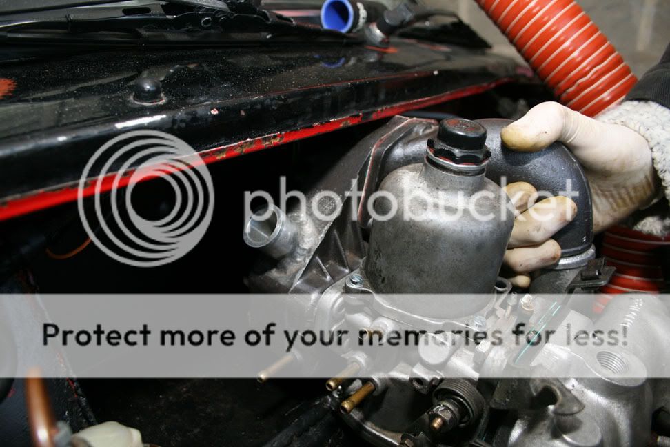

well, got the turbo on today, but we have a slight issue with the clearance between the plenum chamber and the scuttle, as pictured below
i noticed that the scuttle has been replaced at some point, maybe its been incorrectly fitted? though it looks in line with everything else.
i think im going to have to show it the angle grinder unless someone can enlighten me.*surprised*
thanks
adjusable engine steady and push the engine forwards?

exactly the same issue i had...as James says, get yourself an adjustable engine steady and push the engine forwards a bit. project looks spot on as well mate, well done. inspiration to get mine finished
4310 Posts
Could it be 'pusuaded' or is there quite a bit of a clearence issue?
Edit, I mean the scuttle, not the plenum.

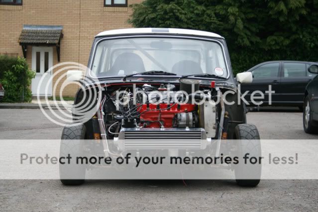

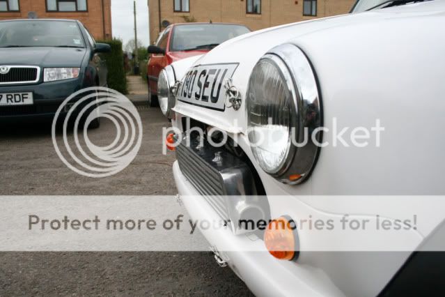

Anyhoo, we got round to fitting the intercooler today minus the pipe work and heres the result...
any ideas on how to fit the grill would be greatly appreciated *oh well*
All that needs doing now is the pipework really and then get the fueling/timing sorted then see how many bananas it produces *surprised*
ill be probing the intake air temps just to see how good this cooler setup really is.
