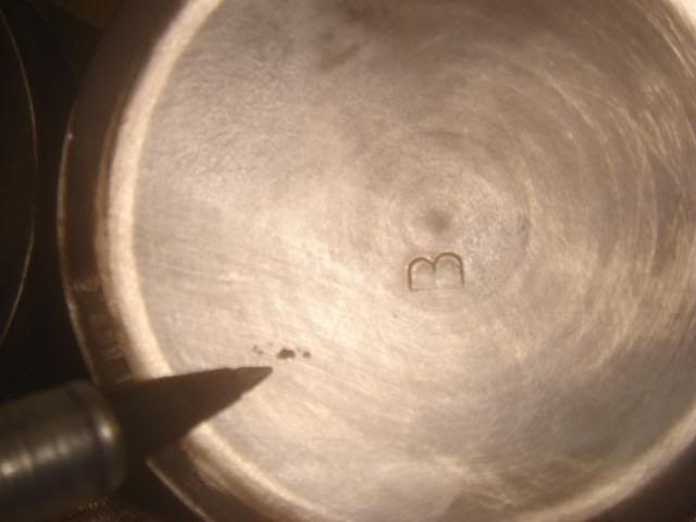

I was cleaning up a set of standard turbo pistons I intend to use and found some damage on the surface of 2 of them. basically it looks like small pits the size of a grain of sharp sand if that makes sense. there is one pit mark in each piston.
no photos at the moment but any ideas what has caused this or if i can still use the pistons??

The pits arent in the same place on each one are they?
Paul
not sure - could possibly be. I'll have a look again
If they are all the same they possibly are to do with manufacturing

or mild det if they are out of a standard one.
I'll post pics asap - they came out a standard engine some years ago and I can't recall anthing else about it.
just want to know if I can still use them
cheers
pics attached hopefully of the damage
any thoughts on if thse are usable?

To me it looks like a small bit of debris that at one time hit the top of the piston causing a slight mark
Definately not Det, so nothing to worry about there.

Should clean up if there's any sharp edges and be useable I'd have said.

that looks fine as said before , i thought like usual it was on the side of the crown
