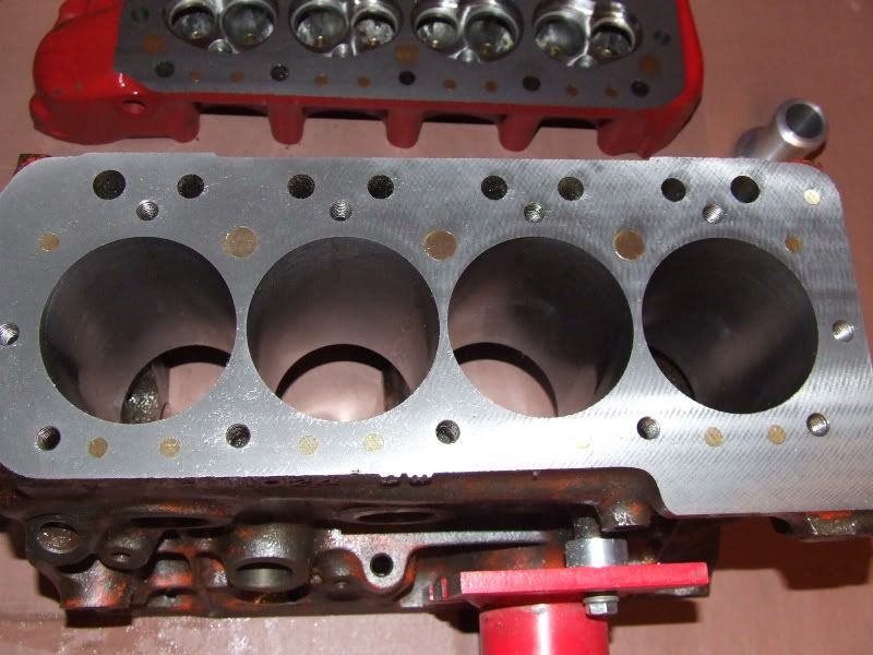

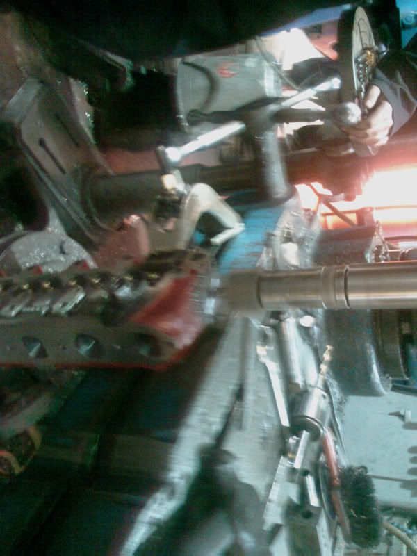

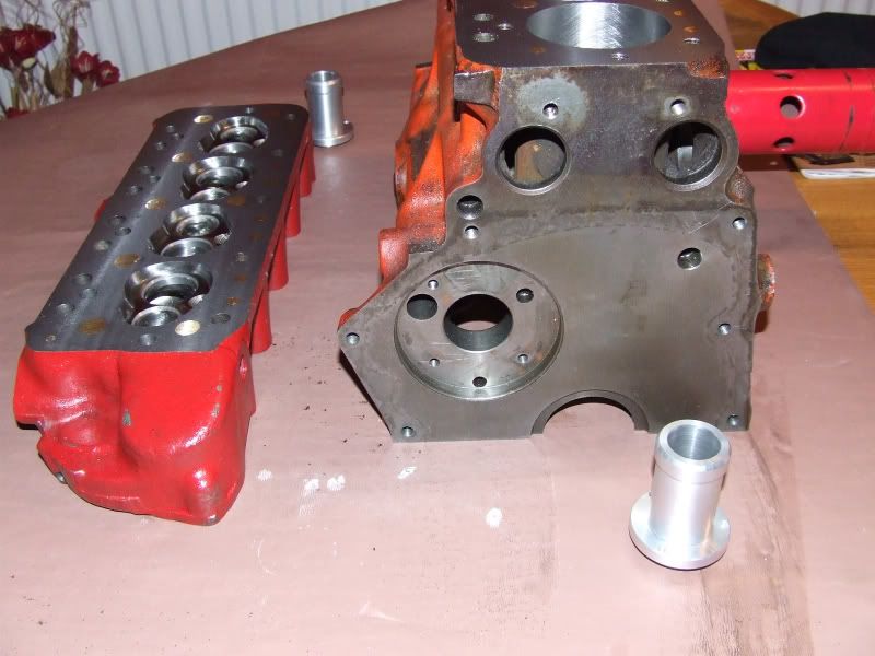

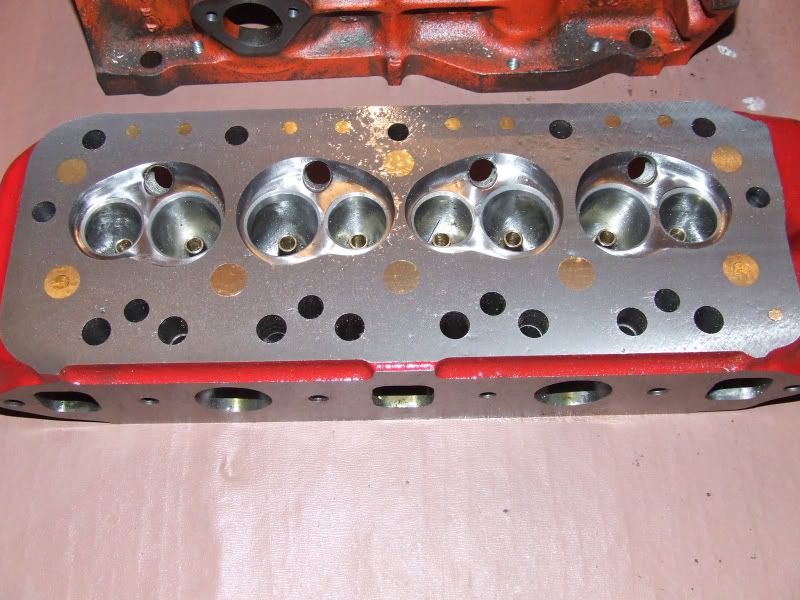

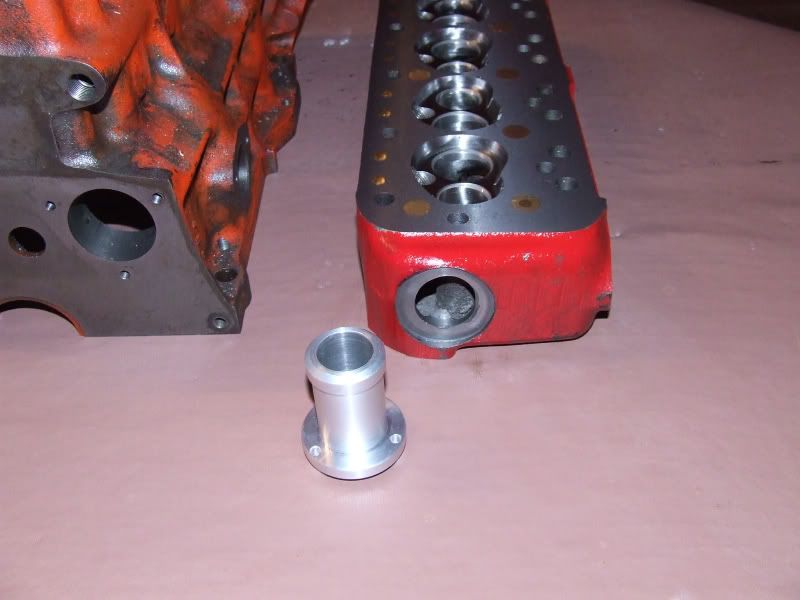

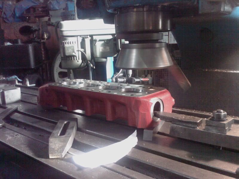

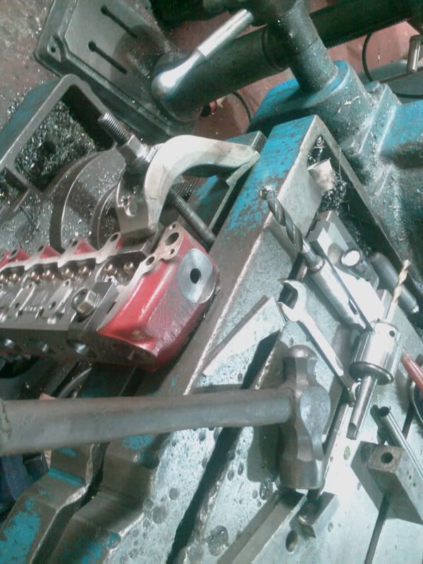

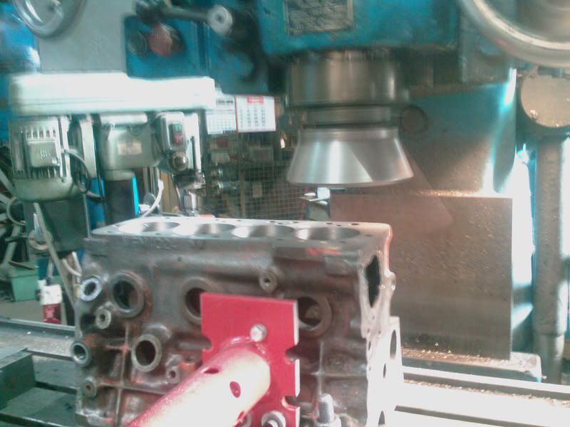

Here are the pictures.

Just a note on this.... I looked at the MED kit and even had a word wilth Steve their.... The MED kit serves a purpose but in my opinion is a kind of half way solution as it doesnt actally keep water and oil from the gasket. It seems to be a steel shim plate that stops just the water transfer.... so if water can get to one side of the gasket then is it actually achieving what you set out to do. I know its more work but hey..... It keeps me amused..... all the brass plugs are G type threads... ie taper threads.... that way they wont ever drop into the coolant even if they did come loose.... They are all sealed with Loctite thread sealant so they shouldnt come loose anyways but belt and braces rules ...... The head spigot hole is easy to spot face but BEWARE..... use a mill to cut the hole that actually caries the coolant..... you can prob see that the old heater tap position provides a part of the casting that drops into the line of the hole you are machining.... If you drill this hole you end up with an off centre hole due to the drill being forced to wander.... I started smaller and worked up till I found what was going to happen then took the lot off the drill and set up on the horiz Mill..... In hindsight Ill do the lot as a milling op if I do another one. I always flycut a head or a block.... surface grinding only serves to make a polished finish..... gaskets get a 'grip' with flycutting and consequently dont move and so last longer.... in my opinion. Their isnt much land to drill and tap for the spigots.... Im using M5 but the block spigot needs a bit removing to clear and match the engine steady fixing.....

Water goes in through the pump, along the block, out of the core plug and then back into the head through the new hole and then takes the usual route into the rad.
There are pics in my build thread (search 1275gts).

For what it is worth, Force Racing sell a titanium adaptor that uses both core plugs to maximise flow if you preferred, they also sell the two individual ports.
When I used my ports, I did not have to open up the core plug itself, just drill and tap the fixings for it in the block.
