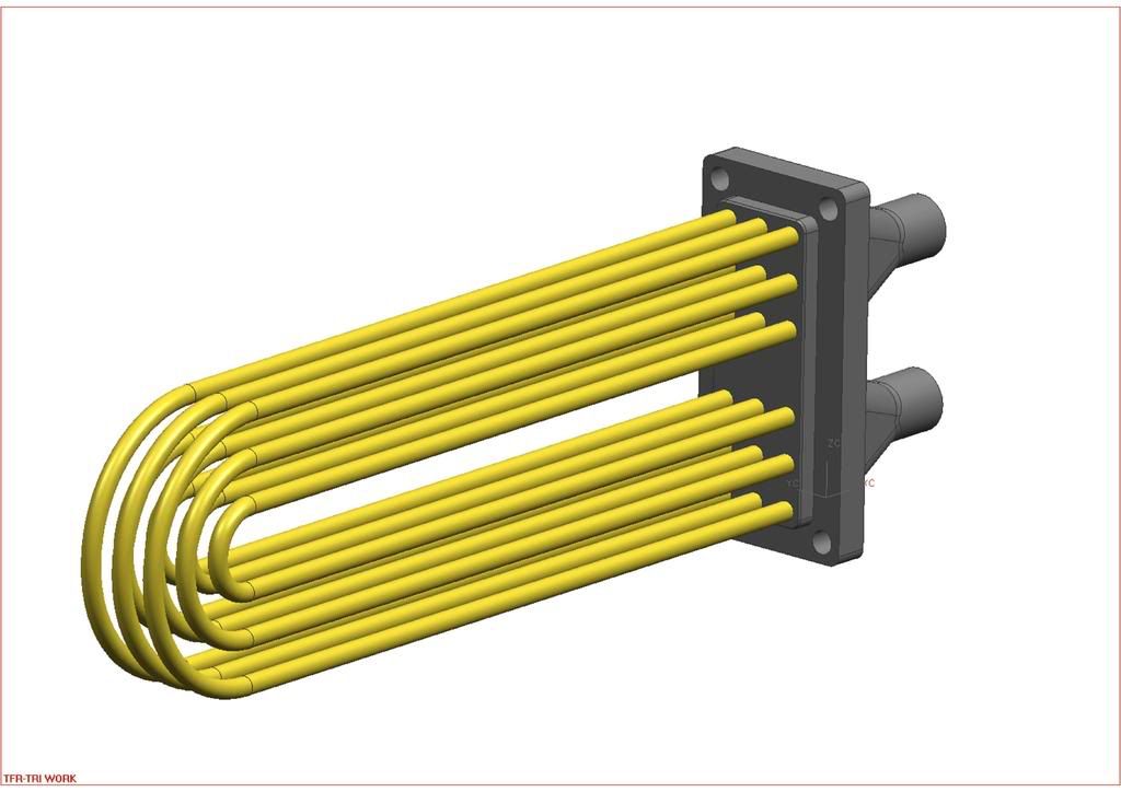

I've got an sc12 supercharger for the 1100 engine im building, but im not sure whether to go with the kit available form ben in australia or to do something different and make it work as a blow through system using the metro turbo plenum and carb etc.
The main reason i'm looking into other methods other than the kit from australia is that it cant be used with an intercooler.
This got me thinking today and ive come up with a plan to use the australian kit and create a chrarge cooler for use with it.

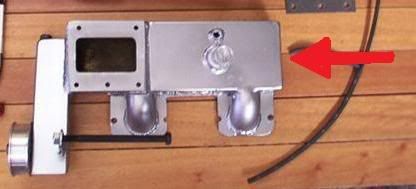

The plan would be to remove one end of the inlet manifold, weld a small flange on and bolt on the charge cooler design shown below.
The idea being that the core is made up of lengths of brake pipe and screwed into the plate using brake pipe fittings.(obviously the pipes would need to be formed around the bolting points for the supercharger
i would be interested in your thoughts ands opinions (will it work??)

The only problem I can see with what you're planning there is space. The manifold for the carb comes of the back of the manifold and folds round where your red arrow is.
There's a good picture in Gr4h4ms build thread on mini adicts.
http://www.miniaddicts.co.uk/forum/showthr...p?t=2197&page=8
It might work better going in the top.

doubt itll work, not enough surface area will be passed over from the carb to inlet, especially at high rev's, the inlet charge wont be in contact with the cold parts long enough to effect a noticable change, imho ofcource. a modern thick ally heater core fed with cold water would be a better solution i'd think? though you will need to redesign that plenum pictured, as the charge would be very uneven.

Intercooling a suck through setup is not a good idea. If the system is efficient, you'll have fuel condensing on the cooler and puddling in the plenum.
