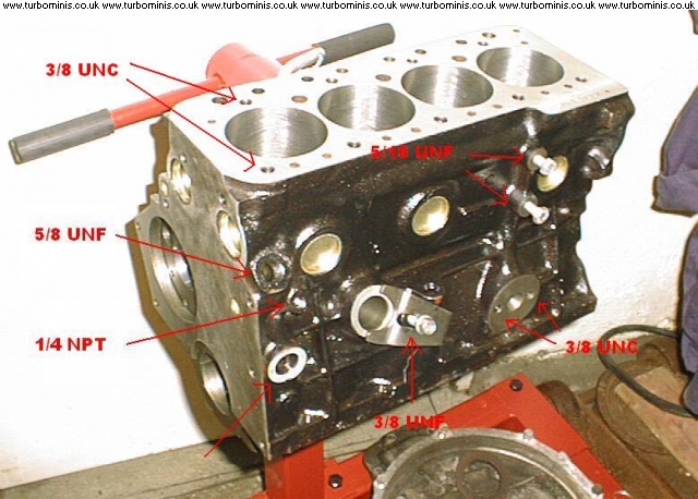

There's a threaded hole in the back end of my block where a stabiliser bar is sometimes fitted. It's in very manky condition, so can anyone confirm what thread it is before I do something rash, like run the wrong tap down it? Ta very much Geoff |
27th Feb, 2009 at 05:31:25pm
is it the one by the core plug at the top lefthand side in this pic ?
![]() 1030 Posts Member #: 1291 Post Whore Suffolk / Birmingham |
27th Feb, 2009 at 05:37:11pm
I belive its 5/16 UNF too |
84 Posts Member #: 2404 Advanced Member Braintree, Essex |
27th Feb, 2009 at 07:59:13pm
That's the one, thanks very much Geoff |
