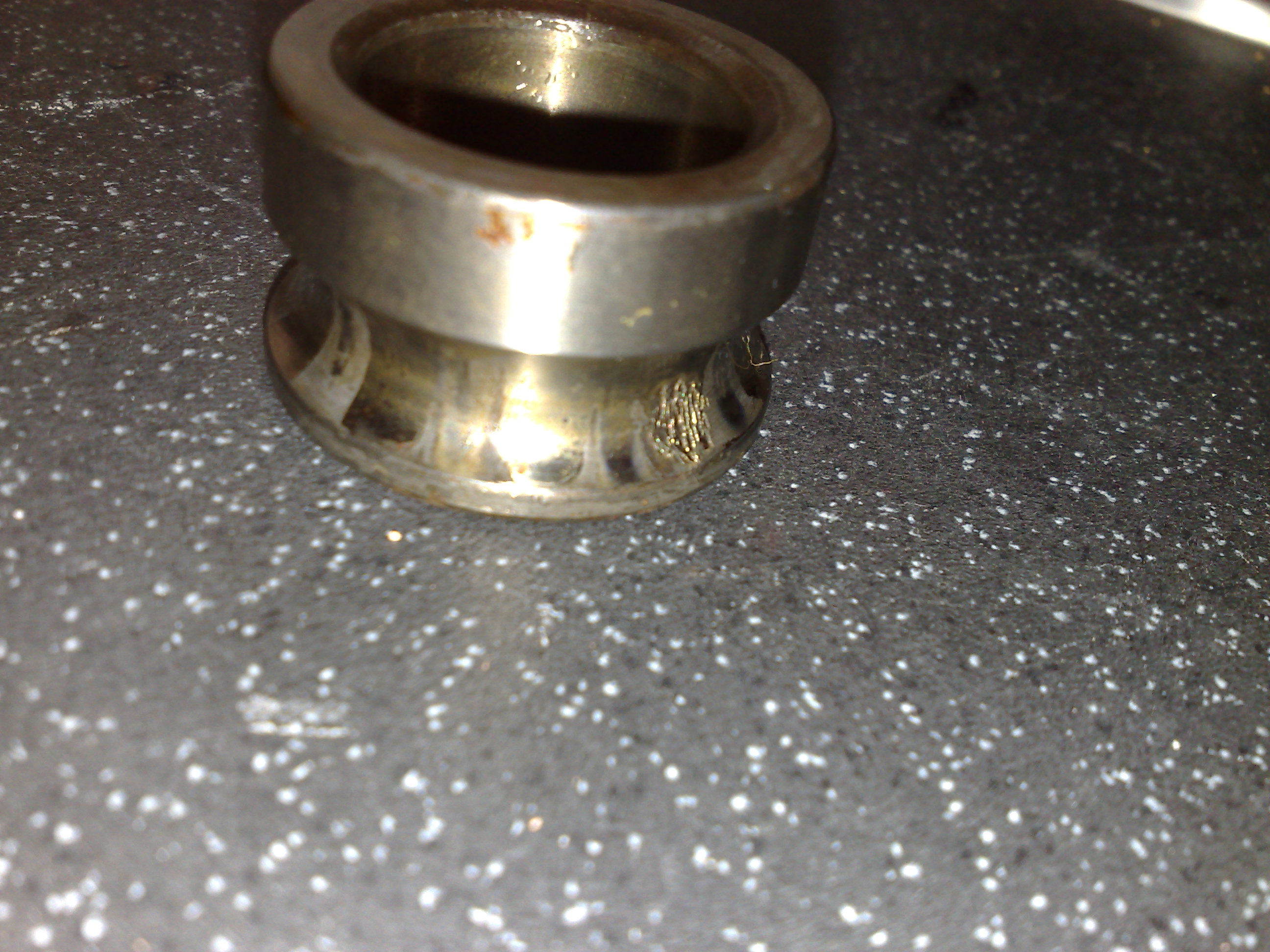

*one off my rear wheel bearings sounds like its picked up some crap whilst i was washing it, can the bearings be split and rebuilt or should i just replace both?..they felt realy good before the clean no play a tall

You can pull the bearings and clean them, but make sure they do not have any wear or pitting, thats when you need to change them

I have myself some non genuine knuckle joints so hang tight on buying some I'll let you know what there like when I fit them and so on. As for bearings, tbh in my experience I'd replace them and both then knowing you have a fresh set and one less thing to worry about.

Bearings, yes they "split" and, TBH, you should split them anyway to examine the tracks for wear or pitting..... Then decide.
cheers guys, i split the bearings down, this morning and cleaned them off, the one that was clicking has some doody scratches in it, i dont know how they could have been made, probably me yesterday when cleaning :(
and the knuckles are seized into my old high-lows they have seen better days anyway, split rubbers seem to be the probable cause
That isn't just a scratch.... it's fooked !!!!
That wasn't your cleaning - it's where the hard surface has broken up slightly, usually just from fatigue in service.
You wouldn't necissarily have heard it turning them by hand whilst it's still full of grease, but as soon as you clean the grease out, you can hear it.
A very good example as to why you should actually examine the races anyway and not just rely on how they feel or sound.....
Aye that ones a gonner
that about sums it up, at least its been found, i pick my new bearings and knuckles up in an hour
