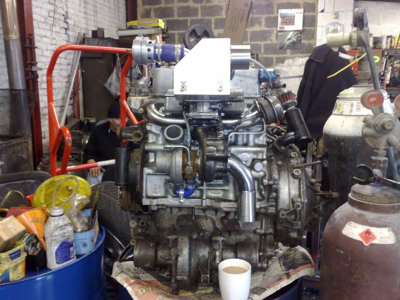

right ive now got this far
im now stuck on how the pipework from the dump + plenum go

oppps the stellas talking...just wanted to no how all the pipework goes that comes out ov the dump to gauge,megajolt ect
Take a pipe from the inlet manifold to the dumpvalve
Take a separate pipe from the inlet manifold to the boost gauge
Use the old vacuum advance take off on the carb to go to the megajolt

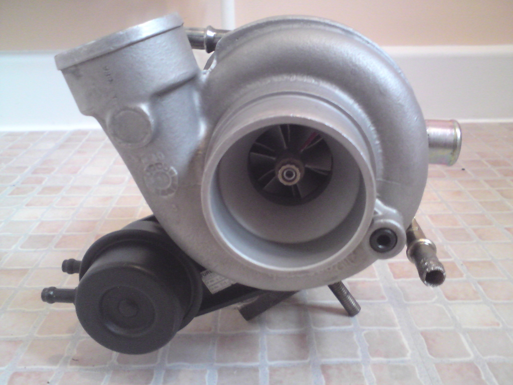

and the one from the acuator ?
From the take off on the compressor housing
:$am i dumb or wot..what take off :$

There should be a brass nipple on the turbo compressor housing for a boost signal.

nope not one on there
4642 Posts
Is there a grub screw type thing anywhere on the compressor housing ?

looks like ive found it...now where would i find a brass nipple to go in it.
Edited by goonerdan on 8th Mar, 2009.
Just take it down to a local hydraulic/pneumatic fitting place and get them to sort you out with a fitting for it

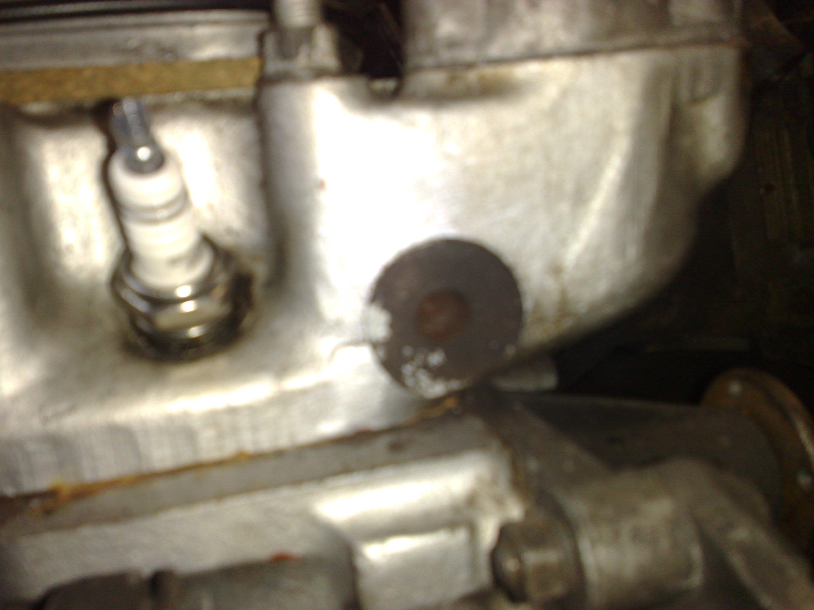

right all sorted no the engine is now in just a few more bits to sort and ill be a happy man....next prob is theres no hole for the temp switch in the head had a look on minispares and the have a stat housing with the hole for one...but out of stock...any ways around this...ta
Has it got a grub bolt in it? Metro heads are like that sometimes. Have a look for an allen key shaped hole where the sender should be.

looks like this
I can't really tell from that picture, but it looks like it has a bolt in it...

Head wants drilling and tapping.
