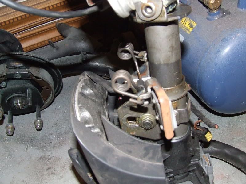

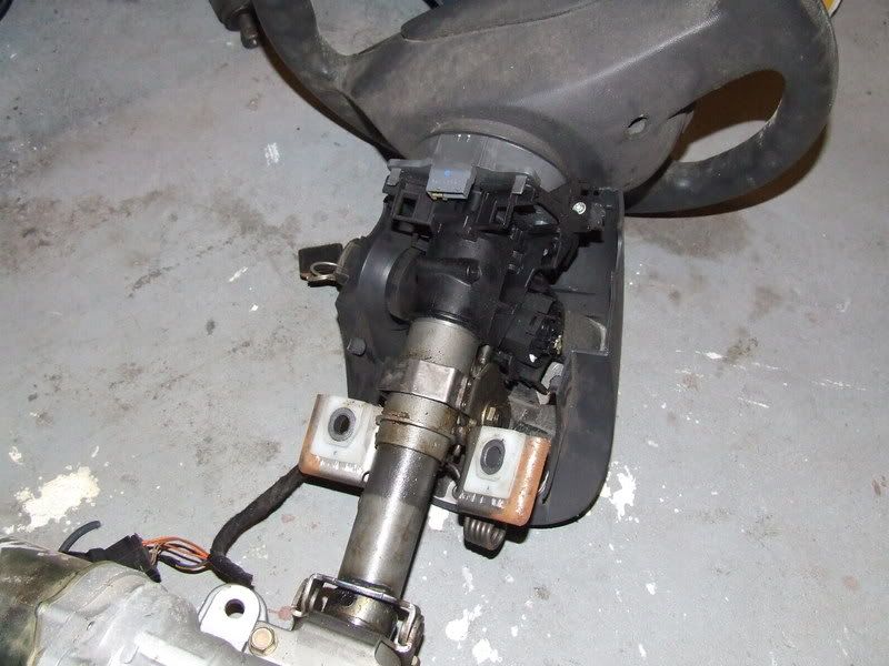

of course i looked at what i thought could possibly be removed, altered, or lightweighted:
Height altering linkage.....pffftttt i dont think so!!!

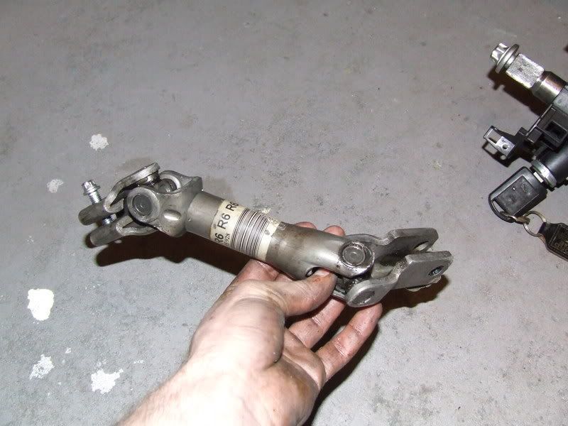

Hefty ass UJ's. Custom lighter set-up could be made as you would have to change the bottom UJ to use it with the mini rack anyways.
Mount. Aluminium? Its going to be custom for you to fit the column anyways.
Then i took it apart *happy*

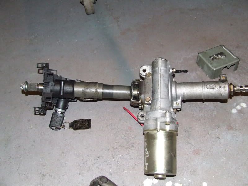

This is the bare coloumn including the Motor, according to my scales (which i dont trust!!) it weighs 7KG's. I will do my best to get this on the scales orginally used for a proper comparison.

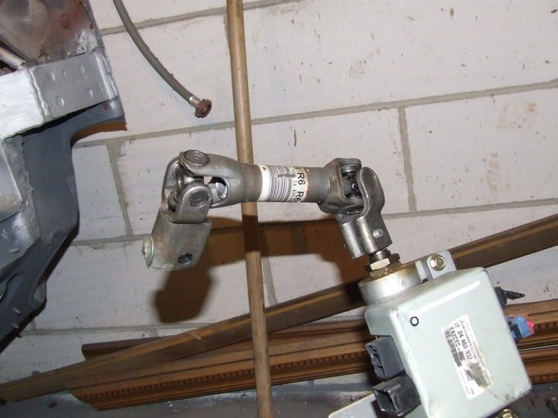

This is the ECU that controls the senstivity of the coloumn, you have to run it along with a box that tricks it into thinking its getting a speed signal.
But check the mount that it has underneath it to hold it in place!!!:
Relocate the ECU and get rid of the mounting plate and the lugs for it on the column.

Great stuff James,
However - you haven't got into the real guts yet! I would be interested to see what can be done to this lump:
As I can see, it looks like everything to the left of the alloy housing could be swapped out for something lighter / simpler.
Also, I would be very surprised if you pulled off the motor and didn't see some major lightening potential in there, say be through-drillind shafts - or even in the motor itself...

loose the barrel and steering lock for one.
Richspec
552 Posts
Member #: 300
Cumbria
Dave is correct, all the left hand side stuff goes and you can put the end of the mini column etc on there.
Extend the wiring and relocate the ecu.
I've left the heatsink on for now.
The two ecu retaining tabs on the bottom can come off, and only a small section of the uj assembly is needed.

i will be hanging onto that part incase i need to use the UJ that connects to the column to make the custom one to suit the mini rack.

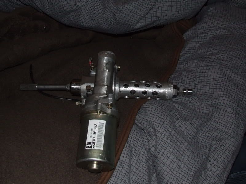

Got it down to 6kg.
if i had a lathe or a mill, i could take more off.
where i have drilled it this part isnt taking any load yet it very thick, lots could be taken from here to reduce weight.
if a new motor could be sourced then quite alot of weight could be saved there aswell. The motor alone weighs ina t 3kg.
the main gear housing, could have a few area's shaved off of it further with the right equiptment, but the motor is quite torquey when first flicking over.
with the right equiptment and possibly some time spent researching the possiblities of a lighter motor i think this could drop to 5kg (even lighter if the motor was swapped).
For me, this will do i think.
when it comes to fitment i will build it up with all of the mounts and steering wheel etc on it, then weigh it again.
so i will have a weight of it as fitted to the car. I am hoping to keep it under 10kg, 8KG will be my aim but the right materials/design will be key there.
