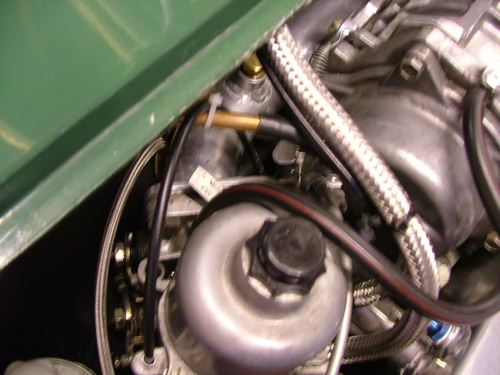

Show us a pic of the install. This might reveal something obvious,,,

an old pic whilst it was getting megajolt
cant see much in the pics but:
Float breather is vented to atmosphere and routed via some copper tube under the car.
Carb breather is blocked off with the old pipe and bolt trick.
Vac is used and plumbed to the SC breathers as it should be.
Do youhave the two holes on either side of the itake (on the filter) that go up to the dashpot?
