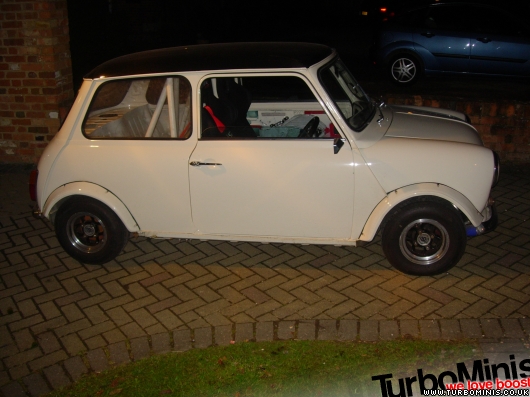

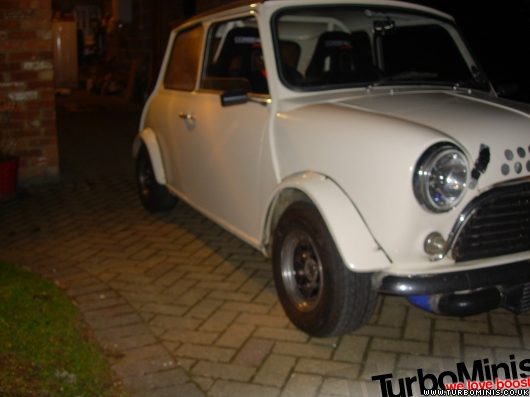

Here's some pics of the hovercraft! lol
VHMMMMMMMMMMMMMMMMMMMM

They look wicked, mamba's yeah?
Edited by richminiturbo. on 23rd Mar, 2009.
richminiturbo.
2370 Posts
Member #: 719
Horndean - Near Portsmouth
Cheers, yeah there mambas!
See what I mean about them not filling the arches? lol When you see them close up they look smaller than 10's as the arches are soo big!
Oh nice impression BTW! *hehe!*

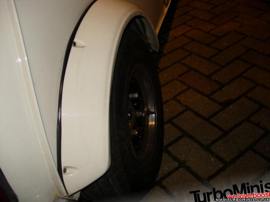

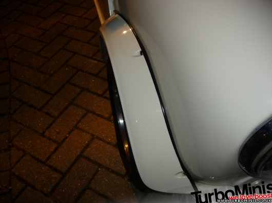

please please please superglue that rubber fillet down near the front gutter,
i know im being an anal twat, but that bit was the bane of my life the other week when i was fitting the arches to my British open classic, i ended up scrapping about £40 of 'p' section rubber and ended up using 1 continuous piece for the whole of the arch to maintain a perfect radius (just trimming the top of the 'kink' around the gutter so the bottom bit is beneath the arch line)
Looks great though, are they W&P arches?
hold on, so that is the 'before' look?
righttttttt...can you not get taller tyres?
I know what you mean about the fillet strip. My new arches won't have that though. And they are a PITA to fit!! *wink*
The tyres are 165 70 10s so can't get taller tyres...
The arches are the MS group 5's. 2.5" wide.
