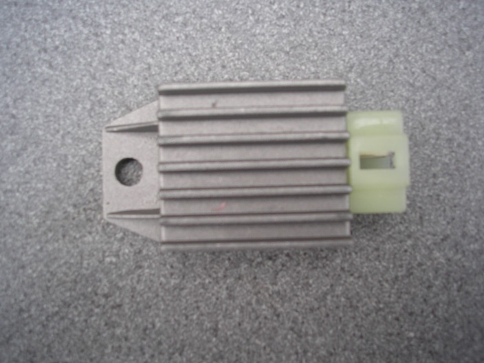

Righto, so i now need one of these voltage regs:
how do i wire it up? can you buy the plugs for them?
James_H
3692 Posts
Member #: 1833
Formally mini_majic
Auckland, New Zealand
i have no idea if you can buy the plugs...
they normally come with a little harness so its plug and play...
if you could find a wiring diagram your laughing...
