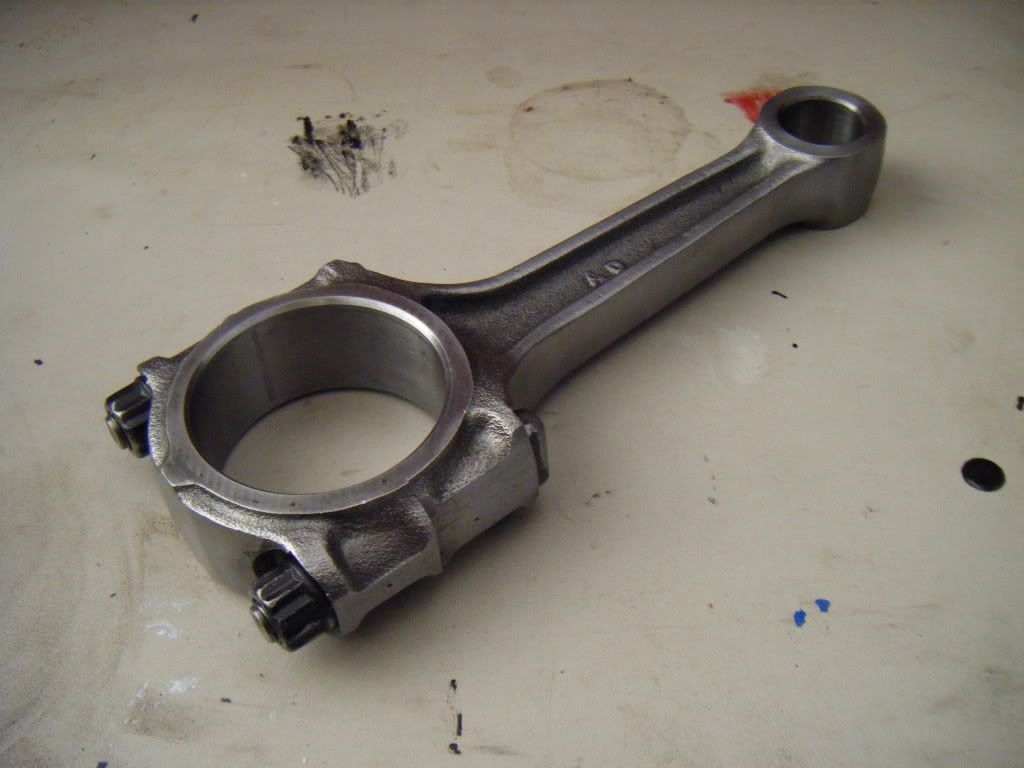

Hi all. A few years back I read an article (I think it was Mini world keeping your mini alive) about modifiying con rods. What was said is that the standard rods have a lot of roughness to them with casting lumps still on them, so by grinding them off and polishing them with a wire wheel would improve their oil drip off. I really hope this is true as I've done this to my rods and hope I haven't weakened them. Does anyone have any ideas on this. :) Gav |

What does shot peening involve. I think I've done a good job on the rods. They look the muts nuts. Really polished. :) |
![]() 6966 Posts Member #: 507 Fastest A Series Mini in the World leeds/wakefield. |
9th Apr, 2009 at 11:19:22pm
fantastic, why don't you post up a pic and we may be able to advise,

Failed parts often show evidence that the failure began at an imperfection in the surface, called a stress riser. Polishing removes a lot of imperfections, so the idea is that the polished part could take more stress before failure, or take similar stress for more cycles. The polishing that we can do with simple tools needs to be along the major stress axis.

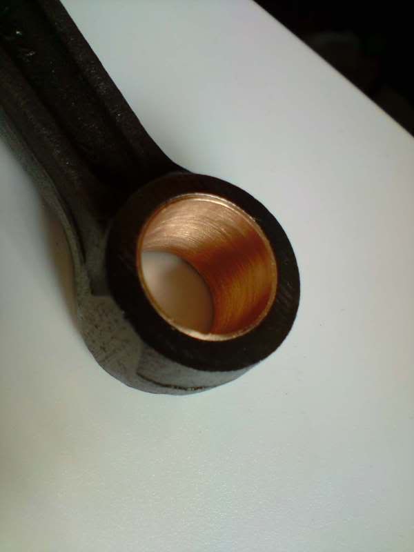

On this subject,has anyone modified rods to fully floating pins,at home ?. |

On this subject,has anyone modified rods to fully floating pins,at home ?. If you've got a reamer why not.. These are my home made rods. It'll give you an idea. On 13th Jul, 2012 Ben H said:

VERY nice work ! I,m starting with Midget rods so dont have to machine away the huge lumps on the caps.

I had a local engineering company put a bush in the end of my rods, to make them fully floating.

i was/am going to do this to my rods, but wasnt going to bother with a bush

Wow Thanks for your interest guys in this topic. My rods look a bit like Vegards but he looks like he's spent more time on his. I'll put some pics on as soon as I work out how to do it |

Sorry to bring this thread up again, but if I've fully polished the rods by grinding is shot peening also needed or can I get away with just the polishing. Is both processes really needed?? I do hope that I can just get away with the polishing as my pistons are now fitted. The chap at the engine centre said that the shot peening would be a waste of money unless I was revving the nuts off my motor and the fact that they are for a turbo motor where the power is at lower revs. I'm also using a standard turbo cam. What you guys think???? Edited by madcatminis on 22nd Jun, 2009. |

Looks like you've done a nice job, not sure how much difference it will make but hey they look nice. Regarding your comment about camshaft, the standard turbo cam is junk if you are after power, it is nothing more than a standard 1300 Metro cam! Ditch it ASAP! Good replacements are the MG Metro normally asp cam, or one of the turbo specific cams such as the Avonbar Ph 2.

I think that you need to shot peen the rods after that. That's because you've now removed the hard "skin" from the forging. Also, you need to check the rods for straightness. Removing the skin might bend rods. I've seen it. On 13th Jul, 2012 Ben H said:
