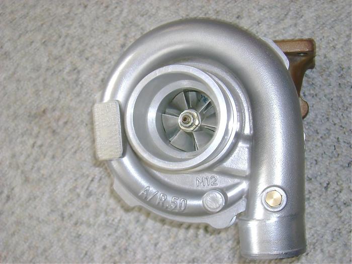

we recieved with joy a 'univrsal' turbo kit last week, all boxed up and nice, orginally destined for a ZZR 1100 but the owner decided not to use it as it was too complicated.

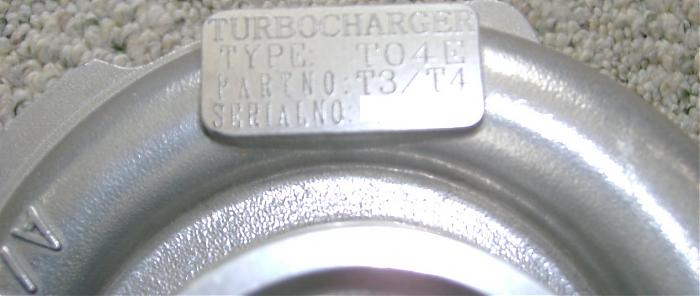

its a type TO4E with part number T3/T4.
is this a suitable turbo to base a conversion on?
The package he has given us includes pretty much everything we need from the turbo point of view including alloy intercooler and boxes of pipe work, silicon hoses of various sizes, oil lines, dump valve etc etc, so it would be good if we can make it work.
Do yourself a favour and sell that piece of junk turbo. Don't even think about fitting it. Just sell it.
Then, decide if you want 150hp, 200hp, 250hp, 300hp and see which garrett fits the bill for you.
Unfortunately that looks like a "made in china" special turbo, some things the chinese are good at copying, others (including turbochargers) they are not so good.
As Dave says, sell on the turbo you have and then look at what you want to achieve.

think id get a second hand saab aero mitsubishi tdo4 ,and try that ,thatll flow enough for what youll want ,and still give you good response ,and be economical .incidentally ,thers a fiar few chaps on turbo forums that run the cheap chinese turbos ,and love them ,so you could give what you have a try ?

It did cross my mind - would it be worth taking this one to my local turbo-tecnics outlet just down the road and get them to spin it up to see if its any good? get some figures off the test rig before we dispell it?
the TD04's look like good value.
another thing I wanted to bear in mind was if this one failed for any reason its pretty cheap to replace ?

ignore tmf. "use a T2" is liek sayign "use a car" to go shopping? a people carrier or an elise? besides show me a T2 based turbo thatll flow efficiently for a genuine 200hp :)
as above have had experience of some china turbo's lasting fine with many hard miles, but have also seen them shatter (compressor wheel, no less) filling the intercooler and engine with shite. im a big believer in bang for your buck, but always take the educated choice, find a good second hand mitsubishi/ihi/garett that suits your needs and buy a rebuild kit for peace of mind.
