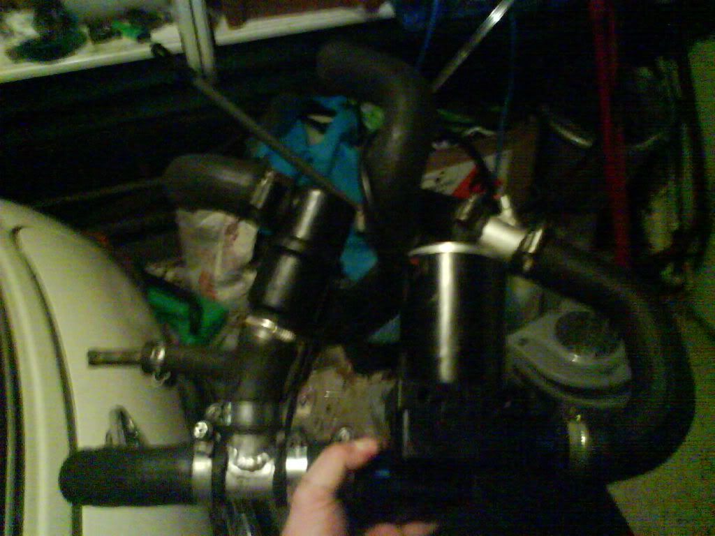

4642 Posts
Here's the pics of the controller I used.
Edited by Turbo Phil on 19th Apr, 2009.

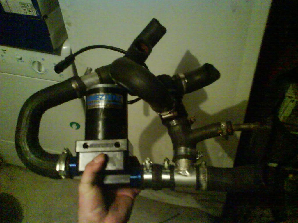

Get yourself sorted with a meziere pump 80ltr/min. They are the nuts...I barely have to use my electric fan!
Im running a chinq front rad and 80 degree external bypass thermostat. Im also cooling the turbo with this sytem, have no heater matrix, and no mechanical fan. *wink*

Yep thats the one! *wink*
And this is how I have it plumbed in...

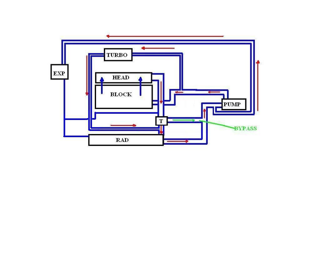

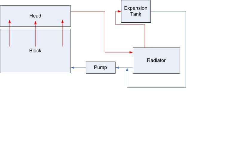

I made up a quick diagram of a proposed cooling system. Is it plumbed correctly? The bit I am most concerned about is the expansion tank. Will the pump simply empty the expansion tank and run dry?
EDIT: Bastard paint cropped some of my image. There is supposed to be a blue line running from the expansion tank to the inlet side of the pump. I will ammend it later tonight
Edited by GaryOS on 28th Apr, 2009.
On 30th Apr, 2010 Rod S said:
Gary's description is best
GaryOS
1424 Posts
Member #: 2810
Formally spanner181187
Dublin, Ireland
Pic Fixed:
Edited by GaryOS on 26th Feb, 2010.
PaulH
1346 Posts
Member #: 2340
Dublin Ireland
That looks spot on dood, there is no fear of the pump running dry. As long as the level of water in the expansion bottle is higher than the taping you have going to the suction side of the pump. as the system fills it will eventually push water out the overflow into the top of the bottle thus filling the expansion bottle and then down back into the pump.
