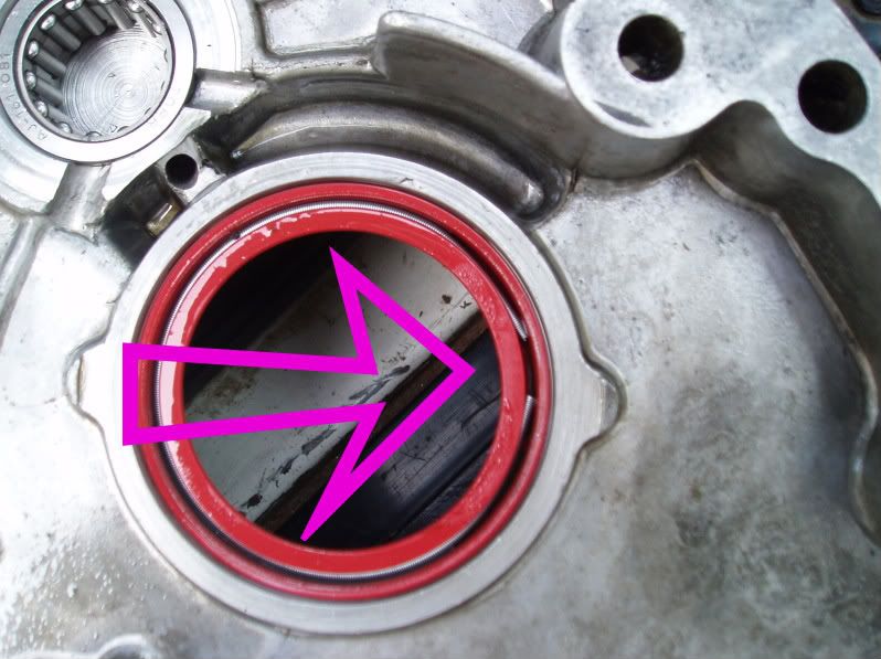

Knowing I had a very sorted car and driver behind I kept my foot well in during the early part of the race. I must have lead for around 10 laps then we struck a problem, we started to get clutch slip in top over 7000rpm.
I was taking lines to make the car as wide as possible but Bellamy reeled me in and took me due to this lack of top end, the cars are very well matched otherwise.
I stayed right on his heels for around 6 laps using the advantage of his slip stream to take the pressure of the clutch.
The clutch began to get worse and I resided to the fact I would not get past him so nursed the car for a finish, soon Metro ace and veteran Dick Trevvit was on my case, I held him off for a couple of laps but with the worsening clutch he found extra legs on me and took me so I was now in 3rd place.
After 20 mins and 17 litres of fuel the race ended Bellamy taking the laurels, Trevvet then me, fair start to the season.
The car was very strong with the same top end as the best proving Phils head is producing the goods.
I have already had the clutch cover off and found the oil seal was leaking, it was a new item, but the spring that holds the tension had broken, never seen that before but will source a new genuine one ASAP.

Sounds like a fair start to the season JF. Shame about the oil seal, sounds like it cost you the win. I will have to get some tickets so silverstone.

The offending item...
