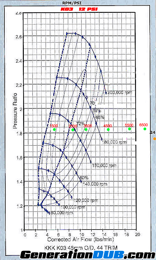

I was looking at a KKK KO3 in a scrap yard to day for very small money it was on a 20-- SEAT IBIZA looks like a nice little unit I could not see any A/R on it but looking online I found a Compressor map and it looks close to the GT17.
Has anybody looked at these are they any good ?
I'm thinking of buying it and having a better look in side one of the VAG forum and it looks like they have a 360 bearing as standard although I take what they say with a pinch of salt.
attached is a compressor map for one,

uased on the cupra's dont see why they wouldnt be to bad
6753 Posts
that compressor map is good up to 130 bhp ...is that enough ?
Edited by robert on 19th Apr, 2009.
it makes around 190 on the 1.8T engines but becomes very inefficient at around 12-14 psi i believe....that doesnt mean its good for 190 on our engines though!!
if you can find a cupra r then they use a K03S and are more efficient at the higher boost levels.
i know of one first hand that is running 253 bananas. and was running at over 25psi (idiot didnt know his wastegate signal line had come off) ran like this for around 5 months....! turbo is still good but it cant of been very efficient up that high!
