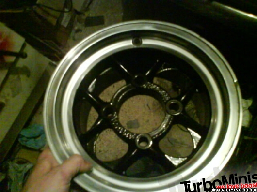

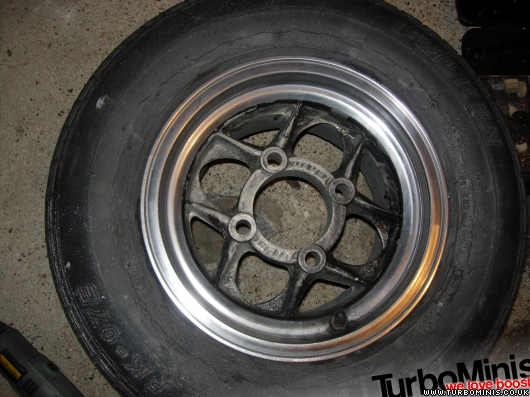

Ive spent the last 2 hours polishing my wheels and I can't get the finish any better than this....
So far ive taken the laquer off, sanded with p400 (wet) sanded with p1500 (wet) then polished with a polishing wheel using T-Cut (all I had, and thought it could work! lol) as a rubbing compound. Any ideas how to get a more of a mirror finish?
With regards to the centres, would smooth finish hammerite be ok? And will it give a reasonable finish? Do you need to prime the ally before you apply the hammerite, as it says you can apply directly to the metal?

i wouldn;t think smooth hammerite would finish nice enough for a set of wheels, best off spraying them.
as for the rims have look on ebay for an abrasive polishing kit, they're around £40 and will bring the rims up to a mirror finish.

T.Cut is a nightmare on alloy! I tried this many years ago and got nowhere. It jst seems to get you a greasy kind of finnish. Then I found Autosol! Give it a try. I know a few guys that have refurbed wheels and only spray the centres leaving the alloy bare. If the car doesnt see much winter use it is not a big deal. A wee wipe over every few weeks with autosol keeps them gleeming and now worries about corrosion under the laquer. I did a rocker cover on my other car this way and left it ovr a year before I had to polish it again.

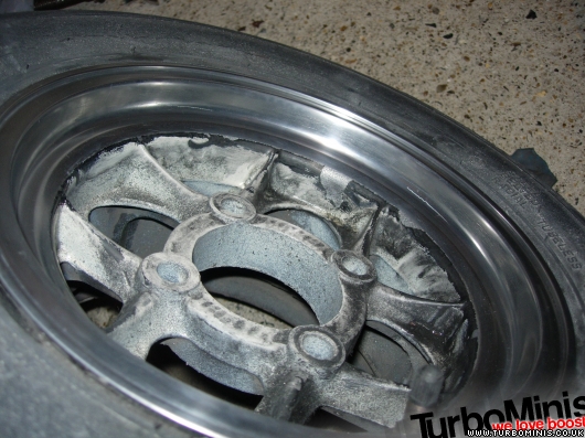

as has been said above ,you need an abrasive aluminium polishing set,
you really need to cut it back with greasy compound [ dark smelly bar] on a sisal stitched mop then a final lick over with the blue bar on the stitched mop and bingo,shinier than Edmond Blackadders shiniest button from his shiny cupboard,

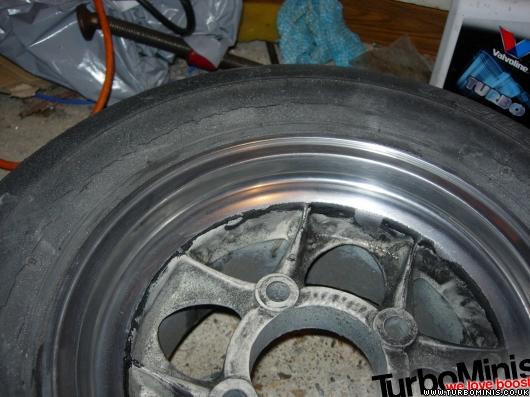

Well I bought myself a polishing kit and it seems to be working really well with the coarse compound (brown) and hard mop but I can't seem to get the fine (blue) compund t take to the soft mop....any tips on how to apply the fine compound onto the mop? It seems to be alot harder than the coarse compound? *oh well*

just force the bar into the mop whilst its running at high speed,eventually it'll take

You need to get heat into it. Like Carl said. Force the mop into the bar. Then let it cool. then apply.

As si says, heat into mop,
i always run a piece of flat plat against my finishing mop to heat the whole thing up before i use it to polish.
if not it just drags the compound around the job and makes a real mess,

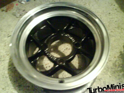

Well after LOTS of pissing around polishing...re-polishing, painting then stripping the paint off and spraying, ive finished 2 of the wheels...20 hours later *surprised*. Hopefully the next 2 will take half that! Im really pleased with the way they've turned out though.
Will get a better pic tomorrow with the new tyres on, on the car. :)

Mmmmmmm matty ! Those look the business mate !

It sounds like you've got the hang of it. The polishes, if they are similar to what I've used here in the States, are wax blocks. Since they are wax, you pretty much need the friction of the the mop wheel to melt the wax before it will take.
It took me 10 hours to polish up just one of my Mambas. When I finished that single wheel, I said to hell with it and had them powder coated in semi gloss black.
