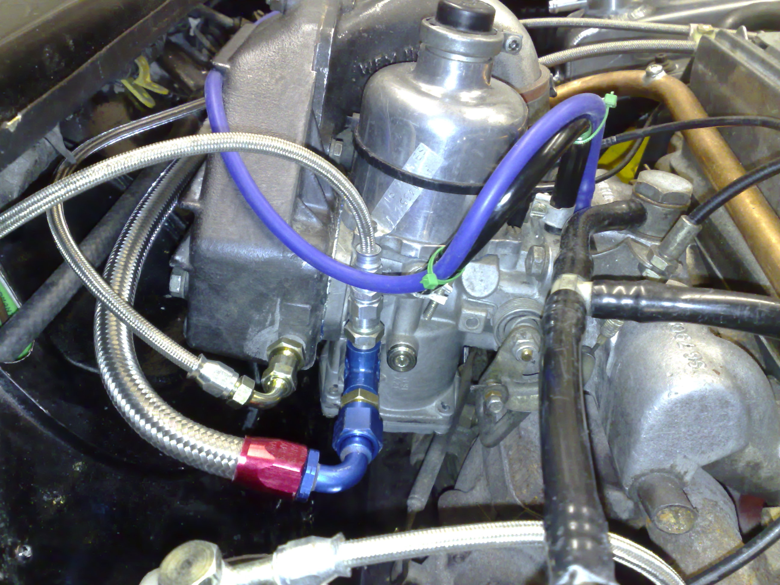

From your description that's the float chamber vent line. most people blankit with a bit of pipe with a bolt jammed in the end.

Here I have tapped and plugged mine.

from your picture there josh the leak is on the oppisite side.
i have the vent plugged as u discribed with a bolt.

Where is it on this pic:
Edit, assuming it is this side of the carb!

got the leak sorted. was the float valve causing the problem. thanks!
