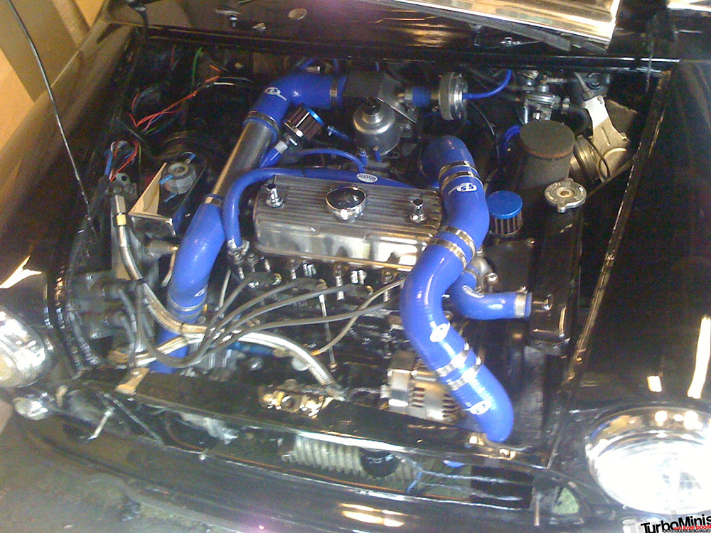

hi could someone upload a pic of their oil feed from the front of their engine to the turbo,
cheers
Welcome to TM

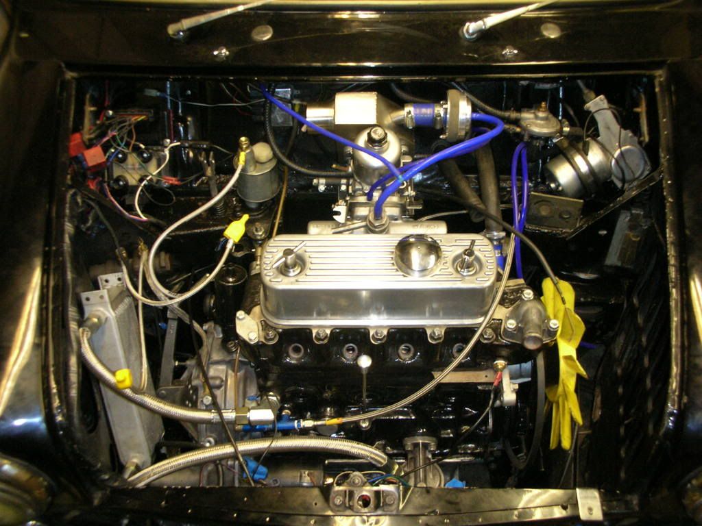

Not the best pic I know, but it's in there somewhere. It's the pipe that goes between plug leads 1 & 2.
What exactly do you need to know?
Edited by theoneeyedlizard on 23rd Apr, 2009.
Found a better one

Same set up as mine same routing. Got it from minispares I think or was it beechgrove engineering

looks like the standard goodrich one to me. Great apart from they fall apart. the aluminium part is the wrong size and so is the banjo bolt. just don't do it up to tight!
"Cars are a lifetime of pain"
Go to your local Pipe Firm, Pirtek Ect and tell them what you want, mine cost £29 all braided fittings!
Spot on.

One suggestion is to get someone to weld a boss/block of ali into the top of your oil filter housing and then drill and tap it to take the minispares oil pipe and banjo or get a new hose made up with a female JIC fitting and use a male/male connector into the threaded boss.
That way, you'll have filtered oil feeding your turbo bearings rather than the standard setup where the hose usually connects via a tee piece in the oil feed pipe prior to the filter.

cheers guys as you may have guessed this is for the oil inlet to the turbo just needed to know where to take the feed from

The Std take off for the turbo oil feed is using the oil pressure sensor hole. This feed is filtered as it comes from the mains and not the oil feed pipe which is next to it. I use to think this was the case, but I was wrong

We always tap the oil filter housing and screw in a male quick release fitting, then put a female quick release on the end of the pipe. We found banjo fittings abit unreliable, washers and all. Our mod seems to work and we never lost turbo bearings. Always think freshly filtered oil is best.
