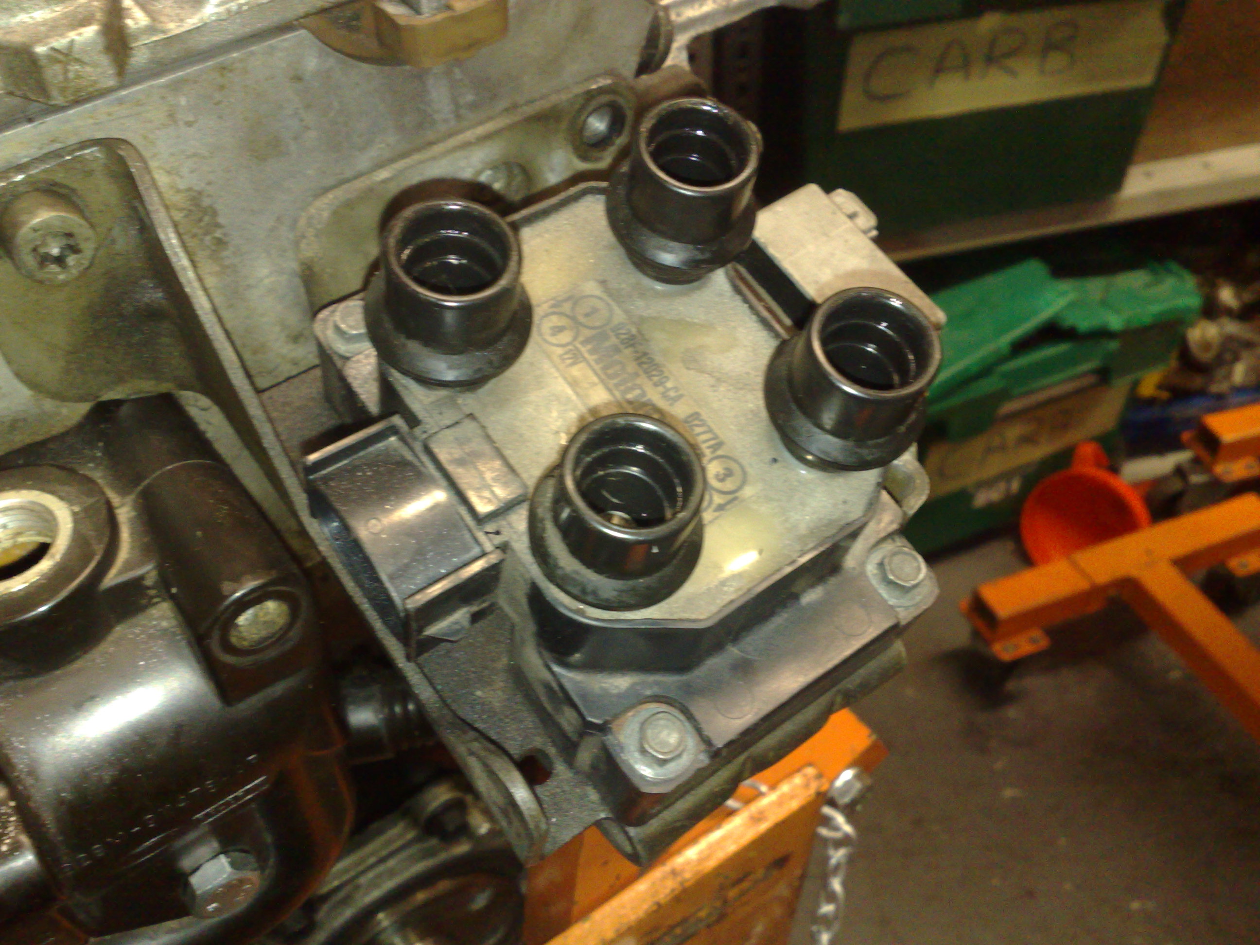

thanks for the picture. Where abouts on the car would this be found?

dont be stupid.... i was acutally at college using internet on my phone and i was in the workshop as we have a lot of ford cars and ford rigs but didnt see any edis bits. i have a pic of the coil pack i have though is this ok to use?
Coil pack looks like the one. Follow the wires from the Vr sensor (thick black sreened cable) this should lead you to it, if its got one. *wink*
OK, so a picture of a Ford coilpack....
But to use for what ??? and how do you intend to use it ???
Ford coilpacks were first driven by EDIS modules and MJ makes use of this so needs an EDIS module but later Fords had the coilpack driven direct from the Engine Management ECU and lots of aftermarket ECUs do the same.
So if you want to use MJ, you need an EDIS module, if you want to use something more advanced, you don't.
So, say what you want to use it on, and what for.....

Strangely I can't quite see the MegaJolt in the photo posted......
Doesn't actually look much like an A series supercharged 1380 road/race engine in the photo either.
Its not a supercharged 1380 in the photo, thats the ford engine rig it came off.
And as posted above, it says in the title "For Megajolt"
