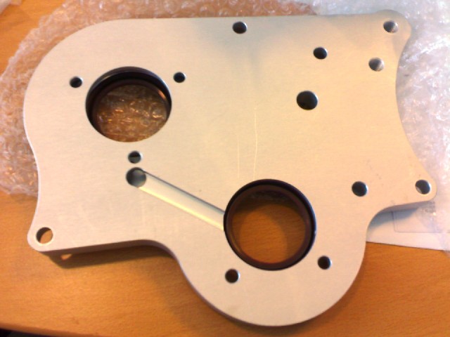

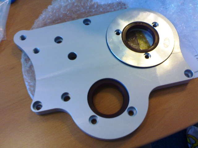

Hi, Was wondering if anybody knows how think the alloy front plate (on front of engine block) used on the KAD16v conversion is.
6965 Posts
mine's a long case head, , so doesn't have that plate,

Ok. Thanks.. Didnt know that there were different types... You wouldnt have a pic of that would you?
I'll sort you some pictures later :)

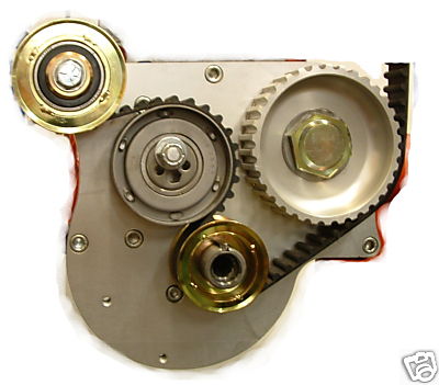

I'm liking the belt tensioner/idler pulley setup on the Kad.... Would anybody have a clue what car they would be off?

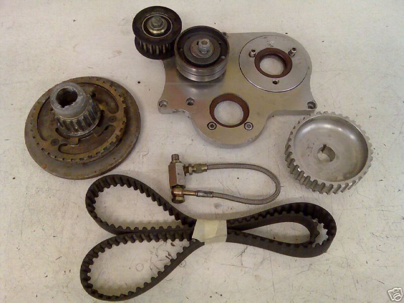

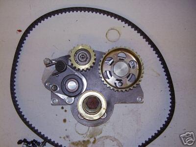

Like the one in this pic? (Thanks to the person I nicked it off)
6965 Posts
i don't recognise that tensioner, unless its like my kads own design with an excentric middle, not ford,
but i think its Dan websters old engine,

I've been searching the net.. Might look like a Cosworth YB tensioner.
Will have to check with my mate as he has a Cossie... Not many of those around this part of the world.
Maybe of the standard 16v Ford Sierra engine aswell? I've seen them like that on a few websites. Can't figure out what idler pulley that is either.. Wondering if the tooth profile on it would match the honda gears.

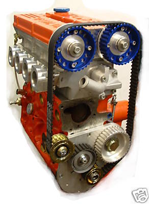

Maybe like this one
http://cgi.ebay.co.uk/Ford-Cosworth-YB-Cam...%3A1%7C294%3A50
6965 Posts
thats similar to or the same as fitted on the DON.

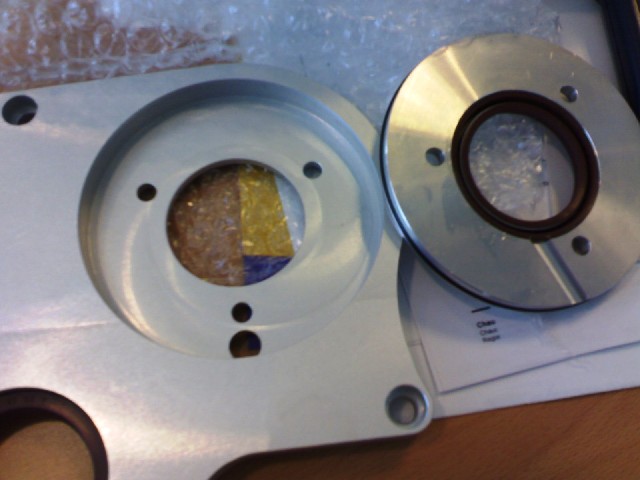

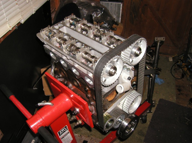

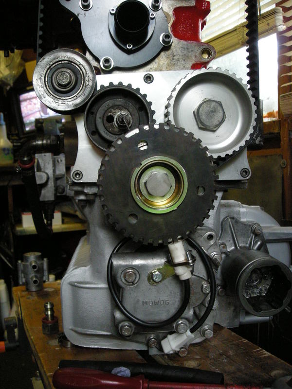

carl talbot
326 Posts
Member #: 1323
I thought the early KAD ones were Pinto
later ones [ eccentric ] were Vauxhall

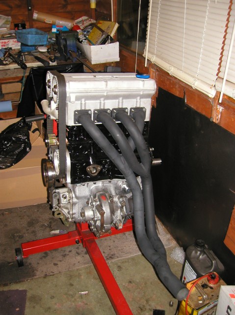

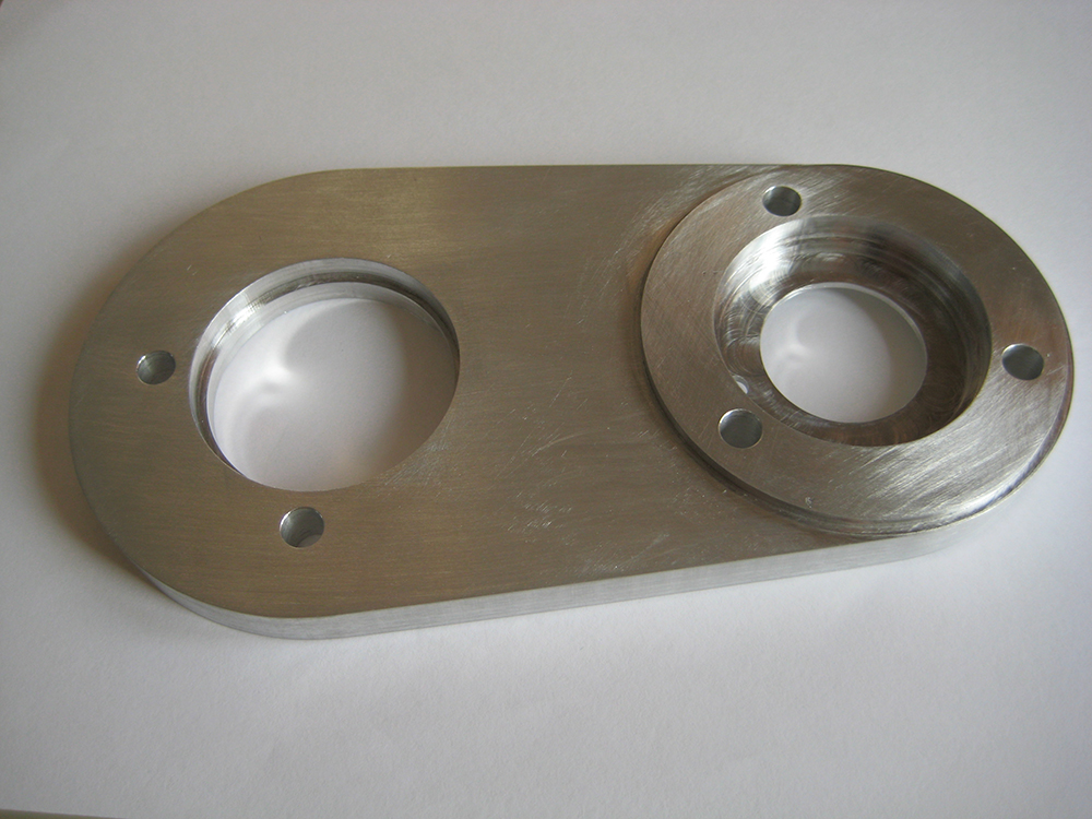

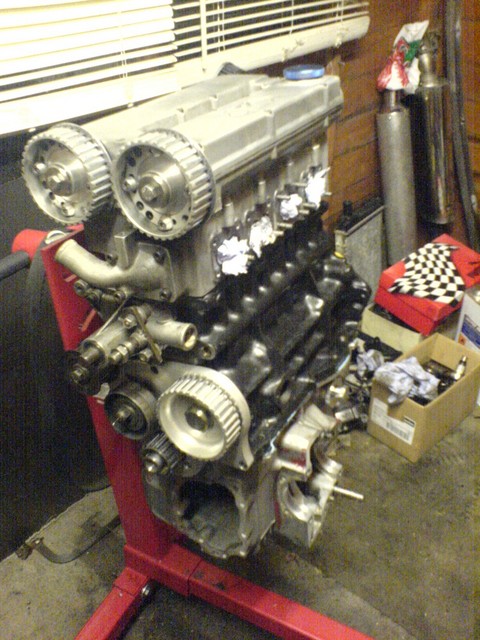

Some one on this forum may recognise some of these pictures*happy*
Just realised the first pic is actualy the JKD plate *hehe!*
Edited by Sprocket on 30th Apr, 2009.
I recon that the seals in those plates are Ford *happy*
I use the Ford Fiesta 1.25 zetec cam seals, 52mm OD 38mm ID and they fit nicely between the cam/ jackshaft triangular plate bolts *happy*

This is my effort, the new design new *happy*

6965 Posts
On 30th Apr, 2009 Tareq said:
The the DON have the idler pulley aswell?
not an dler , but the one you show will work as a tensioner as it has an excentric mount, as is fitted to DON on an early head,
completely different belt arrangment to the ones sprocket has posted.

Sprocket.... Fantastic pics
Thanks for the info Carl..
I'll check my mates cossie's pulleys this weekend.
engine porn!!! *happy*
