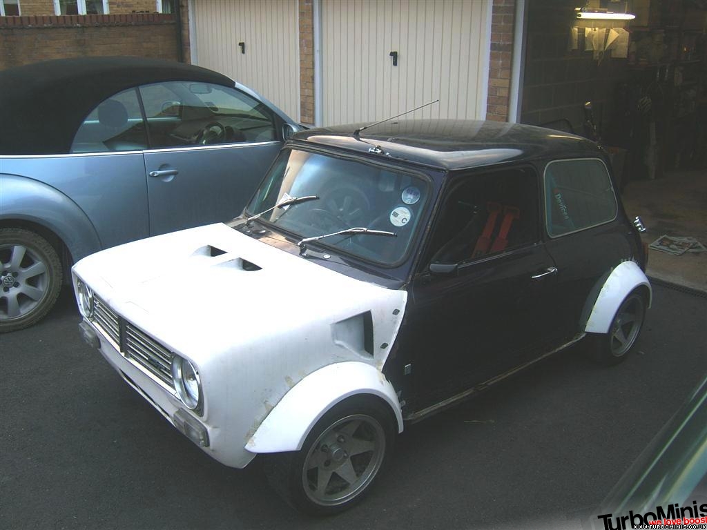

Mine's mounted in the inner wing by the passenger "air vent" with a duct let into the wing.
I'd rather not have to butcher the wing but I did at least try to maintain the body profile by "recessing" a duct rather than "adding" a scoop.
Still needs the filter shielding from the front wheel. Could still work withou t a duct/scoop if you can shield the filter from wheel spray and supply a cold air feed from elsewhere rather than a duct?
I used to have a set-up similar to ministef1, though with a clubby front so dunno how it'll work with a round nose, but the air duct had space to exit in between the radiator and grille, with the air filter mounted directly behind the grille (no pics unfortunately).
Dave.
[editted to add pic]
Edited by Pottsy on 1st May, 2009.
