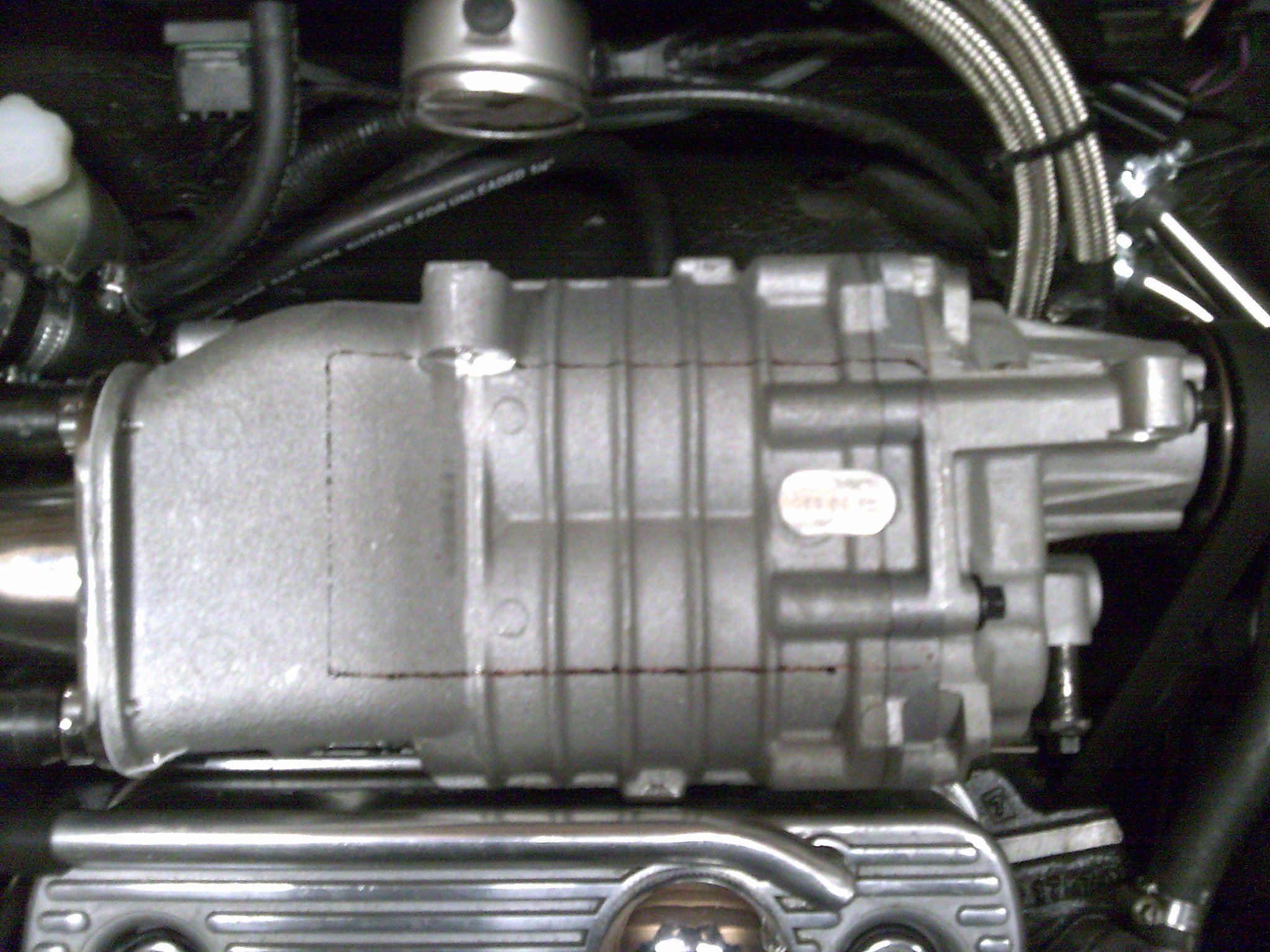

Its a charge® cooler from Vmax, will pressure test it tomorrow and hopefully be able to post up some before and after results in respect to Charge temps and find out if it actually provides much help......i hope so.

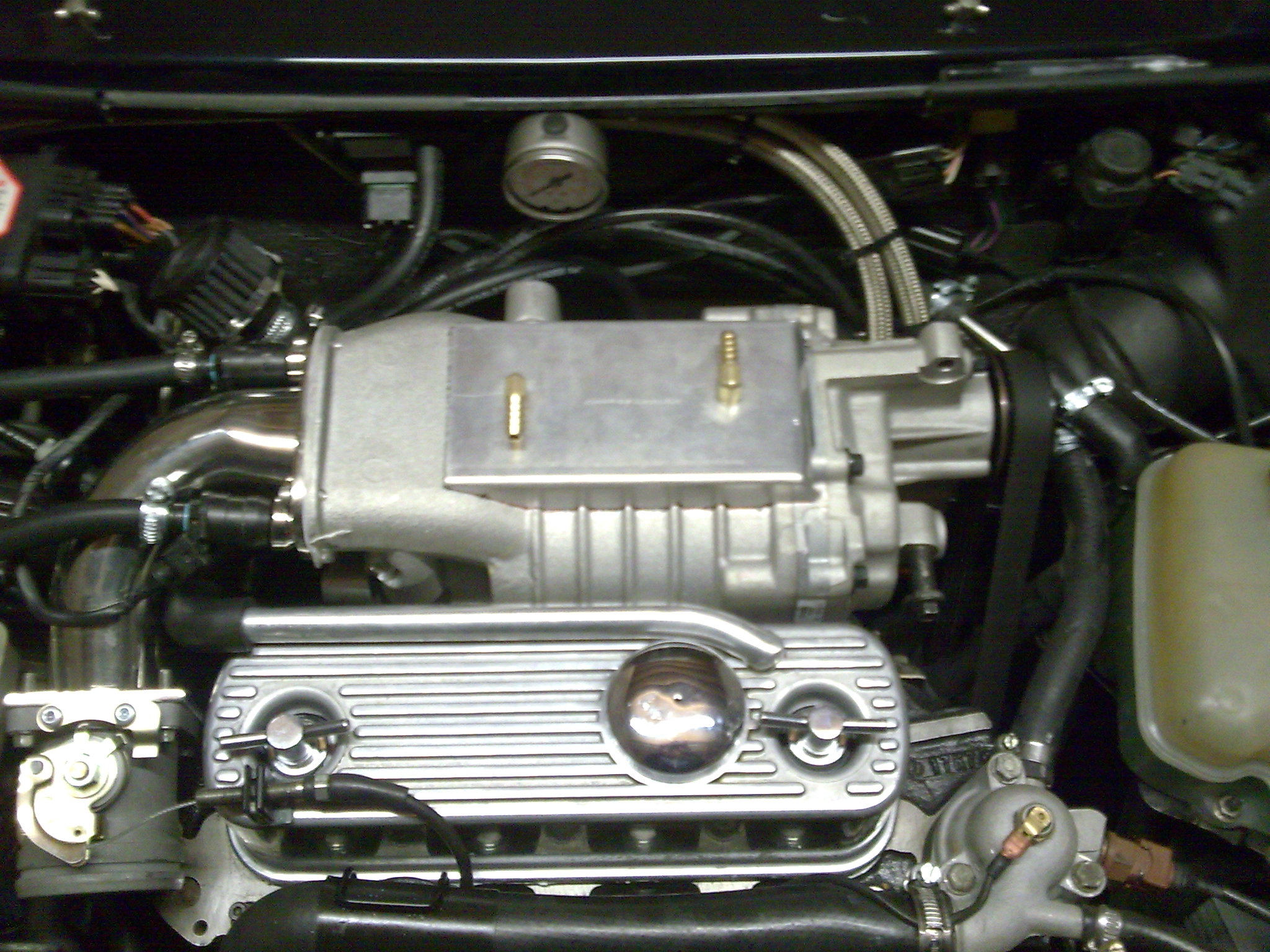

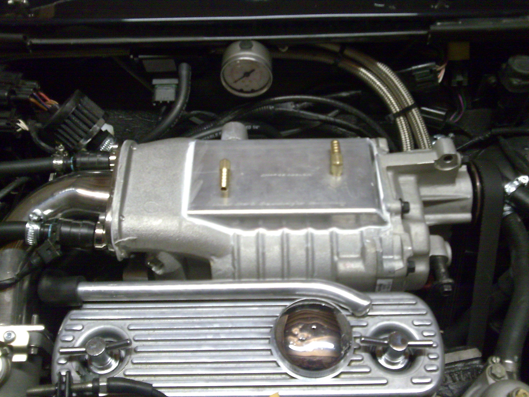

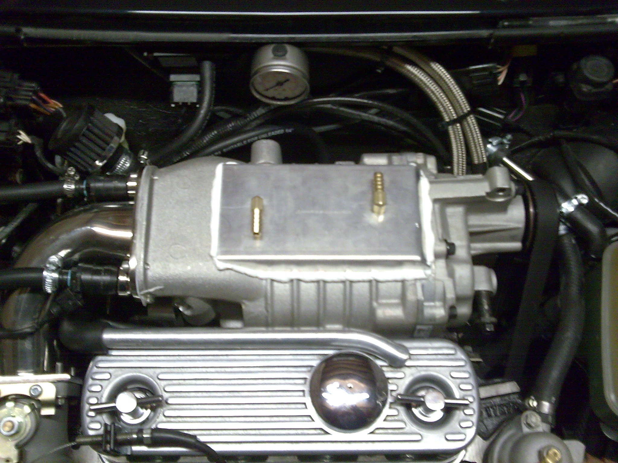

This is the final fitted pic of the heat exchanger (i may paint the sealent). Ive still to fit the resevoir, little rad and pump.
Carl, basically it forms a little pocket of coolant on top of the charger which should carry some heat away from the charger casing the two pipe connectors on top are for the flow and return.. The system is self contained with its own coolant and pump etc. Will post some more pics when i get the rest fitted throughout this week.

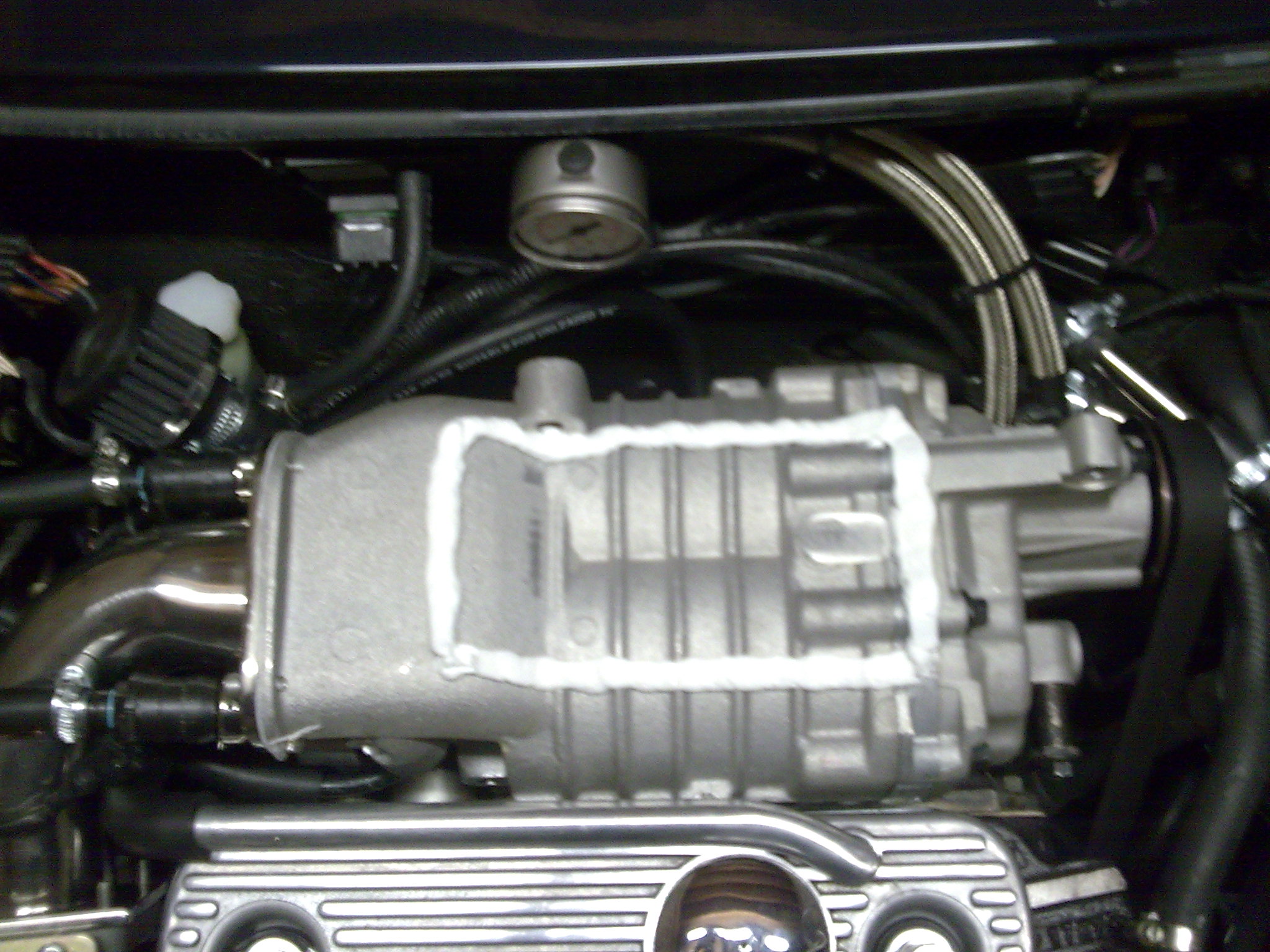

did you take any pics of the other side before you glues it on?
Does coolant come in direct contact with the charger case or is it a sealed unit just sat ontop?

didnt get any pics of the underside but theres nothing to see really. It isnt a sealed plate as i first thought it would be but instead forms a pocket on top of the charger. So the coolant mixture will come in to direct contact with the charger casing (which should help improve heat transfer more than a plate would).
