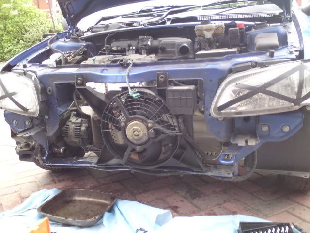

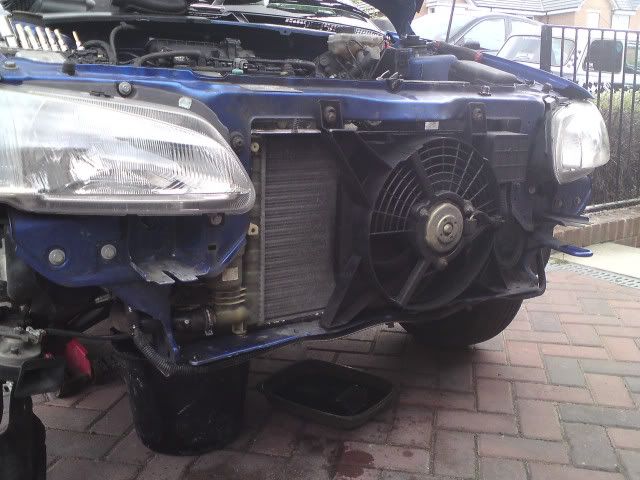

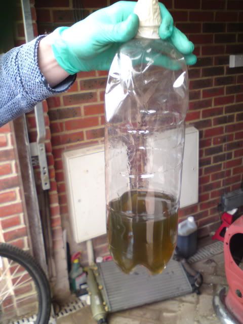

Started off by taking the front bumper off to do a few deer damage repairs and to get to the rad mounting points to remove it, as you can see the coolent wasnt looking so great...

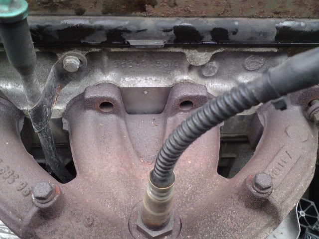

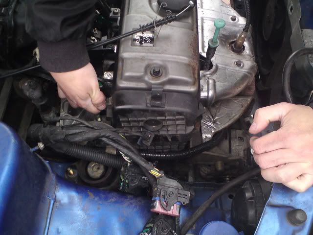

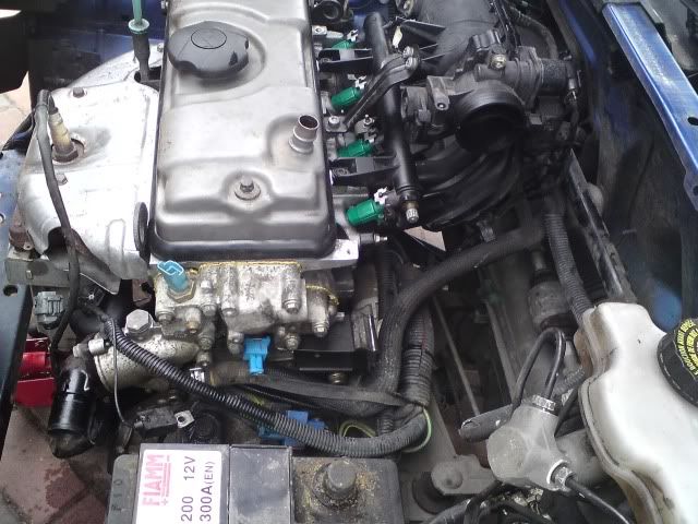

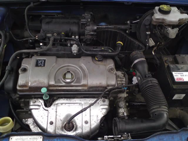

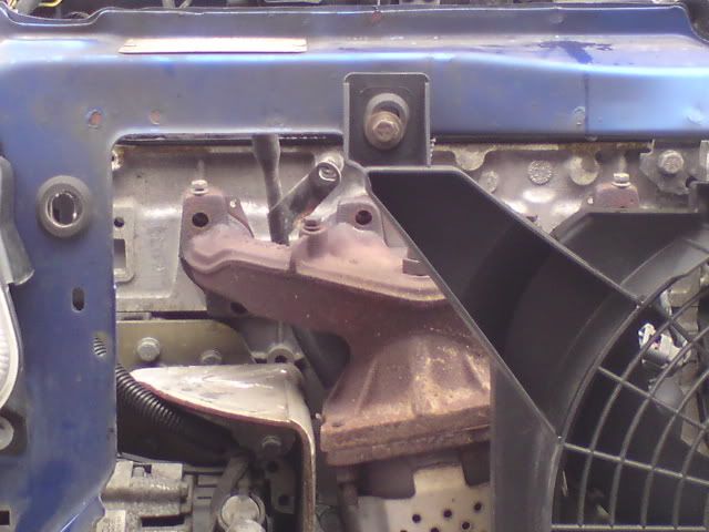

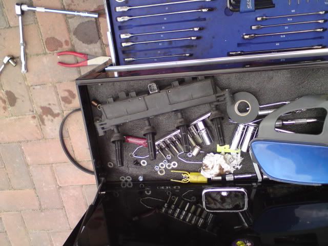

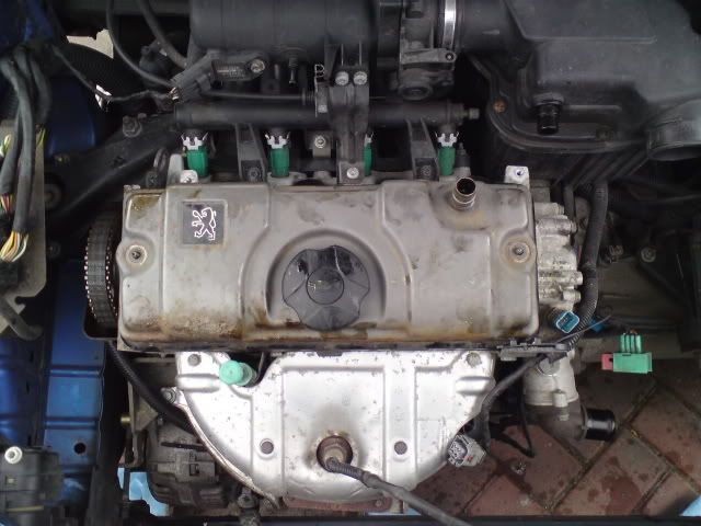

next i started stripping the anoying bits you have to remove to get get the head off easily

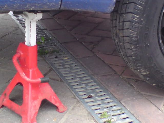

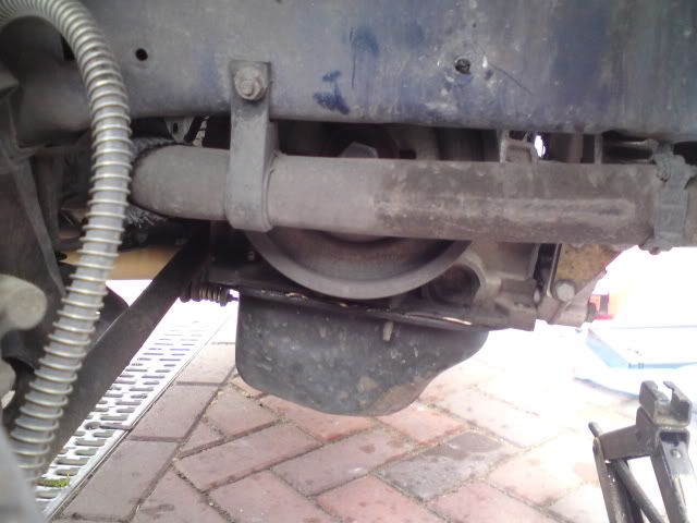

Next i jacked up the car so i had some more room to get the bottom pull off and get at the cambelt

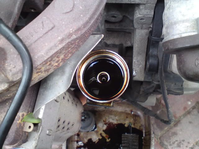

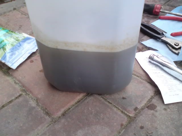

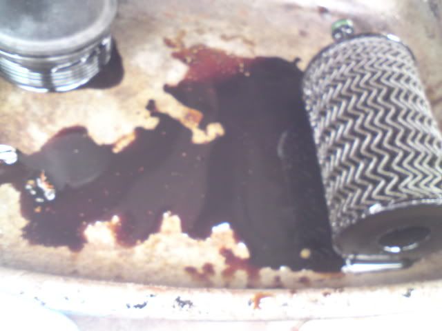

Drained the oil out and removed the oil filter, luckally no coolent here

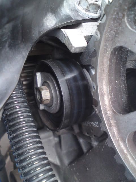

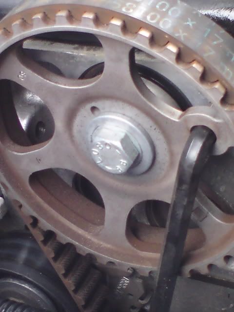

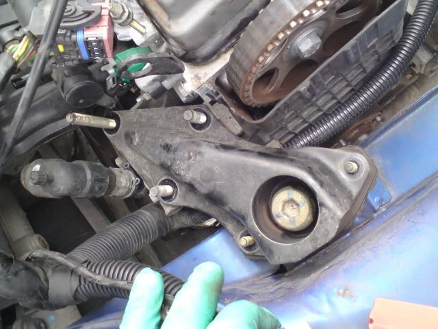

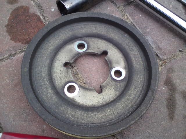

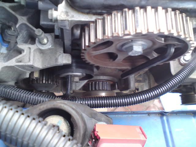

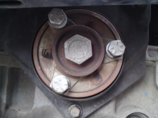

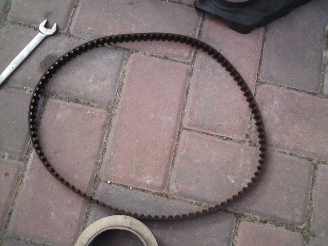

Once the engine mount was off and the cambelt covers were off i set about timing the engine up and getting the cambelt off.

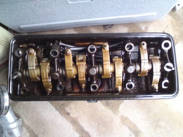

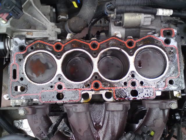

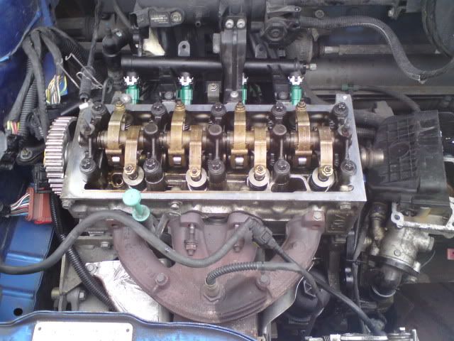

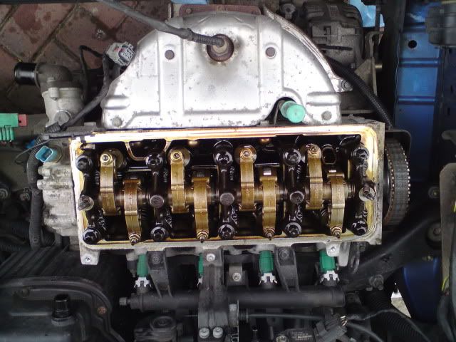

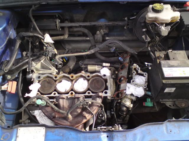

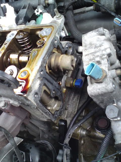

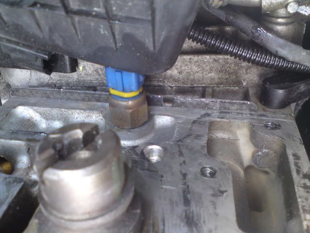

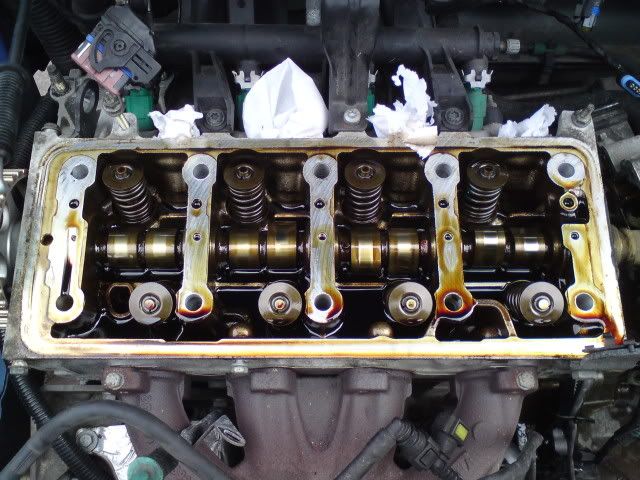

Next was to undo the headbolts unplug the last few bits and bobs, remove the rockers and remove the head to inspect the gasket

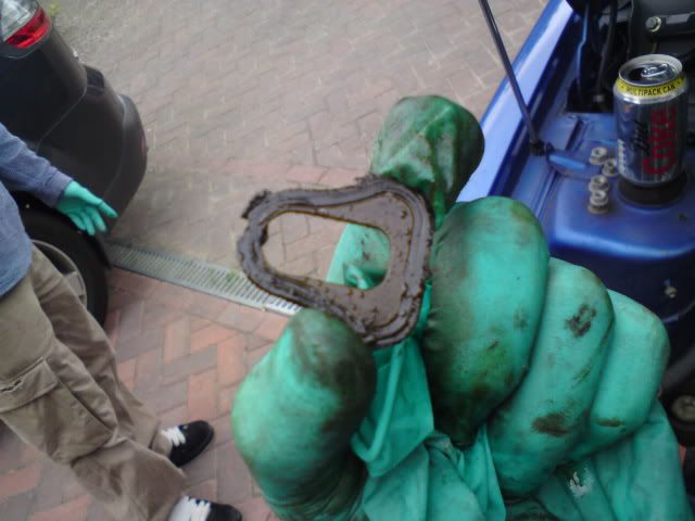

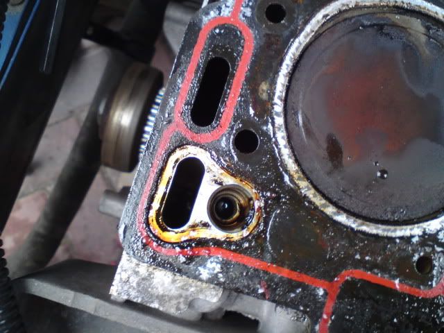

to me it seems as though it started to go between 2 and 3 cought it just in time before it did anything major, there was only mix of oil in the coolent no coolent in with the oil.

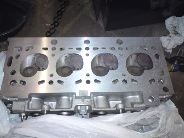

Unless it's a camera artefact, from the 3rd and 4th photo back from the end, it looks like all four cylinders were failing (top left on photo of each one)
I suspect that is for valve clearance *wink*

im not sure either each top of the piston had the clean spots on them they are flat tops so im not sure whats going on there... will have a proper check 2moz.
Its clearance for the valve and the clean spots on the tops of the pistons are as a result of the fresh fuel/ air charge being drawn in. Petrol is a good cleaner you know *wink*
thats good then, i was atarting to worry for abit, well for the hole time it took to post the reply i cant aforde it to be more than the hg lol :)
Looking again I have to agree as they are all identical and match the position of the (presumably inlet) valves in the head.
Strange design though - I wonder if the same head is used on something with slightly bigger bores.
well the head has now been skimmed still waiting on my cambelt kit though. anyway the head is now on and tightend up 20nm 90deg x 3. i have had enough of french cars 2day as all i want to do now is burn it. just a few pics this time.
