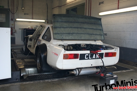

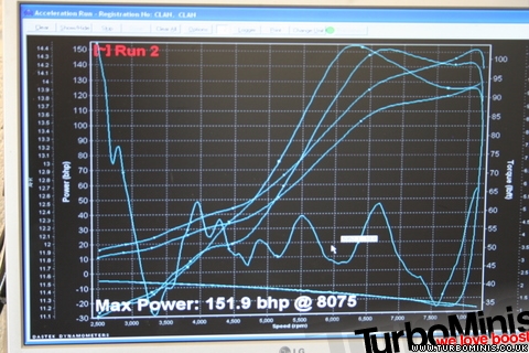

Not a mini I am afraid. I have helping my mate put together a Clan (grp shell with Imp running gear). Today it went on the rollers for the first time. It was the first time I (or the rolling road operator) had mapped using megasquirt so it was quite a morning. In the end I drove the car and did the tuning and he operated the rolling road. It is quite scary to start with. I wimped out when we upped the boost, convinced it was wheel spinning or slipping the clutch. It turned out it was just more powerful than we expected and was just accelerating the rollers bloody fast.
Anyway, in the end it made around 120 bananas @ 10psi and was a sweet as a nut to drive. Injection is so nice to tune, why do I stick with a 5 port head.
Some photos
Ignore the high power reading the rollers were playing silly buggers.

peak at 8k! nice :)
