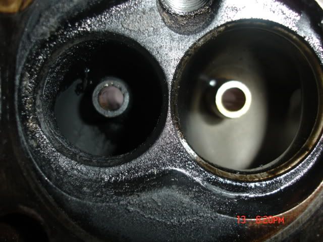

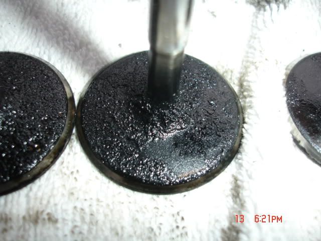

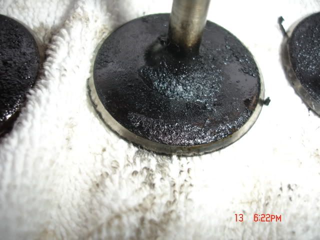

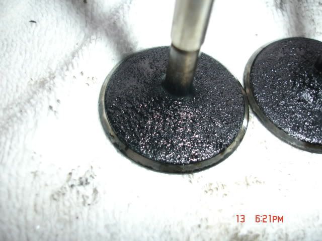

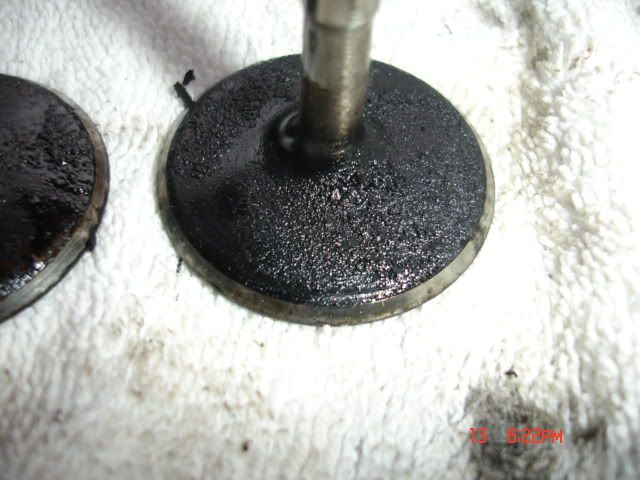

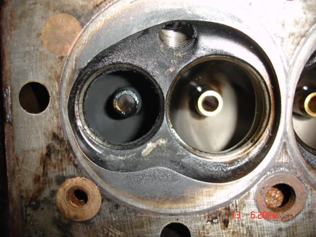

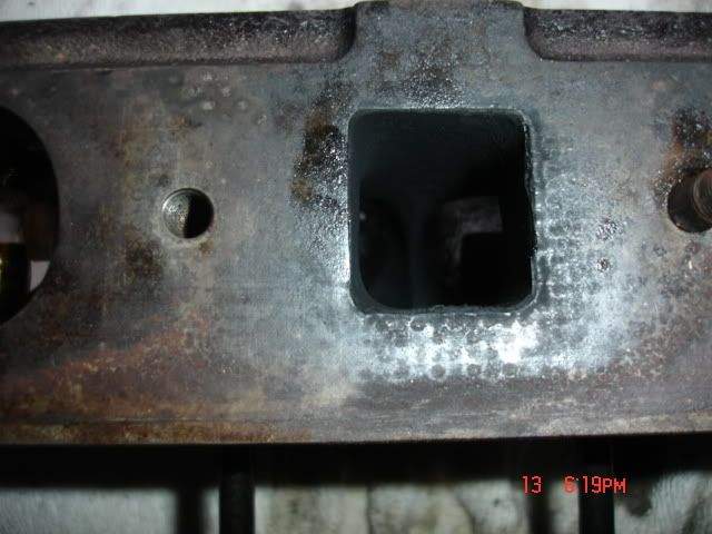

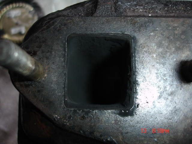

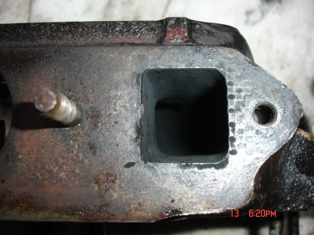

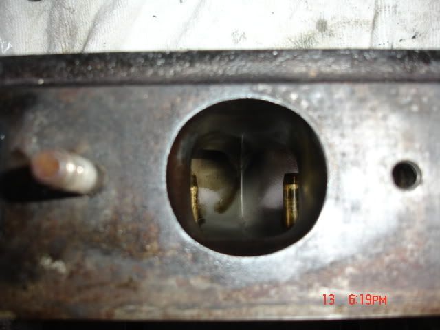

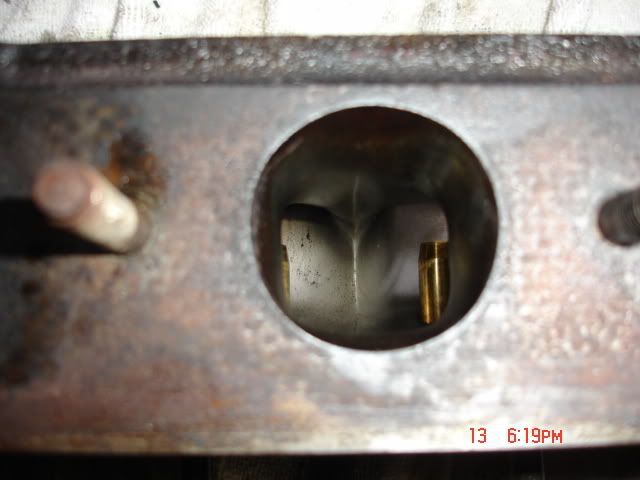

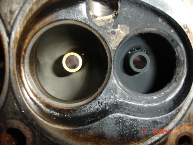

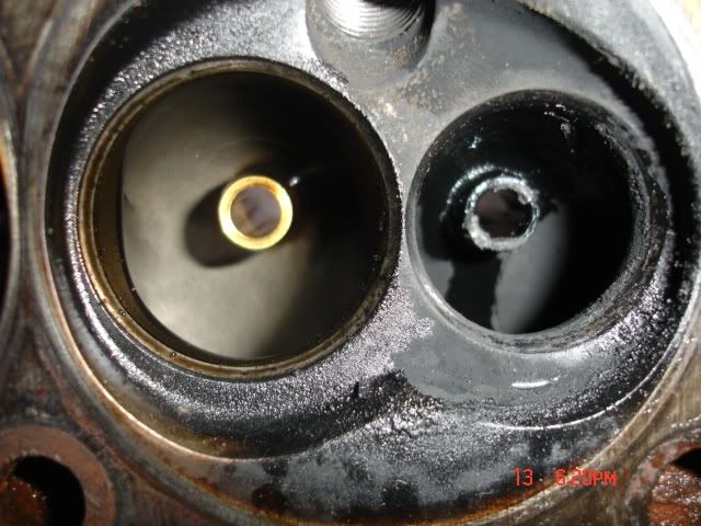

Took my head apart this week, just wanted any thoughts to whether the head could have anymore work done.
Also I am not sure what to think about the condition of the guides. Your thoughts as always will be helpful
Thanks*surprised*
4642 Posts
Those inlets are pretty coked up. What cam are you running ? Was it smoking at all ? If you do get new guides fitted, fit some decent ones that are properly bullotnosed from where they enter the port.
Is this being used on a NA motor, 36-31 valves ?
Phil.
philc
1394 Posts
Member #: 1346
bromsgrove
Cam is VP3C, yes somking, using up oil. Yes N/A, I think 37-31
re phils advice, i would replace all the guides and seals
if the engines done a lot of miles and you have given it some beans,
i suspect the oil controll rings are goosed
what pistons do you run and whats the turbo like ?
philc
1394 Posts
Member #: 1346
bromsgrove
this is a n/a engine.
well, i had the guides changed not so long ago, but still maybe worth doing again. which guides would you suggest??
I also suspect the rings are buggered, i am doing the cheaper and easier options first just to make sure.
in respect of pistons, i am unsure, i have had a good look as i was trying to find out what cc they are, but there are no markings
Edited by philc on 16th May, 2009.
Have someone in the know to check the guides and valves. No need to change them if not necessary. You will have to grind all the seats if doing this as well.
The guides seem to be pushed very far down from the pictures. What is the height from the top of the guide to the spring seat?
philc
1394 Posts
Member #: 1346
bromsgrove
The guides seem to be pushed very far down from the pictures. What is the height from the top of the guide to the spring seat?[/quote]
These vary from 13.7mm-14.8mm, mmmmmmmm what should they be.
4642 Posts
14mm. :)
