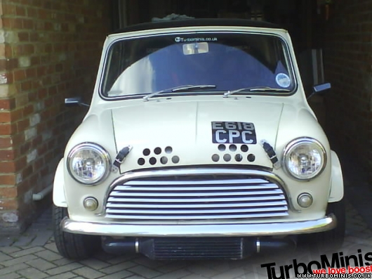

One of my lower arms has adjusted itself and im trying to work out which it is, as none of the locking bolts appear to be loose and they are clearly at different angles. *oh well*
When I turn left it wants to go in s straight line so im thinking its the offside thats adjusted wrongly?
Ive got a pick (not very good) but you can see the camber difference between the 2 wheels (offside angled more). Just want a second opinion on which looks out before I go adjusting it to match the other side.

I had the same with mine and it turned out the top arm bearing had collapsed.
Could be the case as the locking bolts are still tight.
Ah thats interesting, Didn't think of that! I'll have a look at that first. Cheers.
Edited by matty on 18th May, 2009.
Or a knuckle joint.
If the top arm bush collapses, I assume this would cause an increase in the camber?
Ah better not be a knuckle joint *shudder* can't stand messing about with them things!
It did on mine. It also caused a drop in ride height.

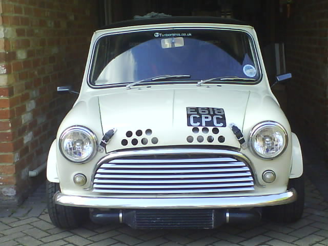

I think I have a pic somewhere...
You can sort of see here...
