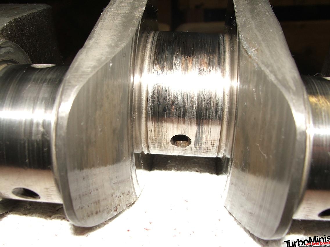

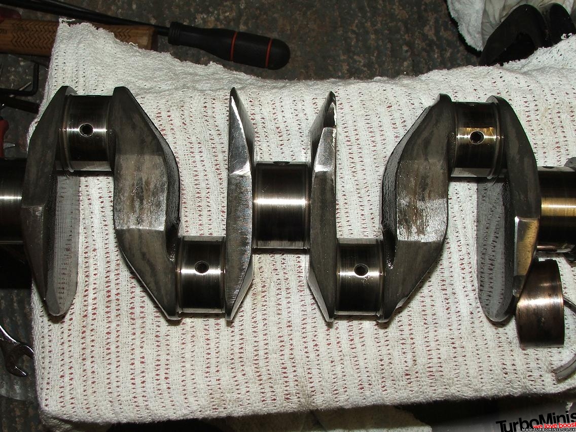

Right then
Crank DOES need a regrind, in my opinion*oh well* There is some blue'ing of the center journal only on one part with some ridges.
What I dont understand is that if the center bearing has been starved of oil, why are nuber 2 and 3 big end journals perfectly ok?
I will check the bearing housing ovality, but I am confident that it is perfectly OK.

Wow...
If all the bits around the first two piccys are the remains of the shell linings, you are very lucky not to have had a catasrophic failure...
Being piccy, it's lead bronze, not copper, that is behind the lead indium, but to destroy top and bottom shell and still be running is....... unusual !!!
If all the other shells (main and bigend) are OK, I would not suspect oil starvation - if the feed to the centre was starved then 2/3 bigend should have failed as well...... do their journals look worse than 1/4 ???
If all the other journals and bearings are OK, I would think that pair of shells were not fitted right (sorry, something like the tab holding one out of place, or the cap not clamped down right) or the crank is bent....
Just my thoughts.
